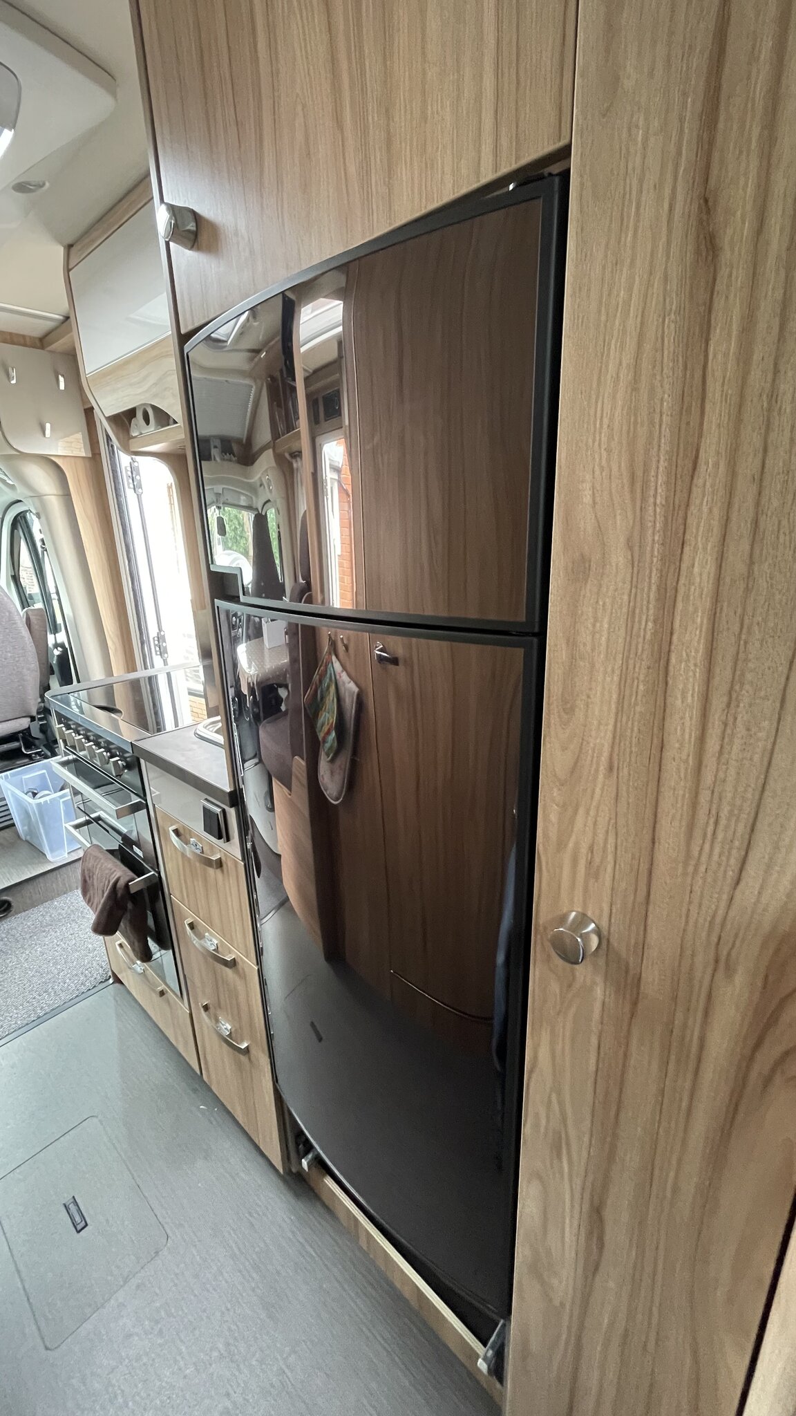

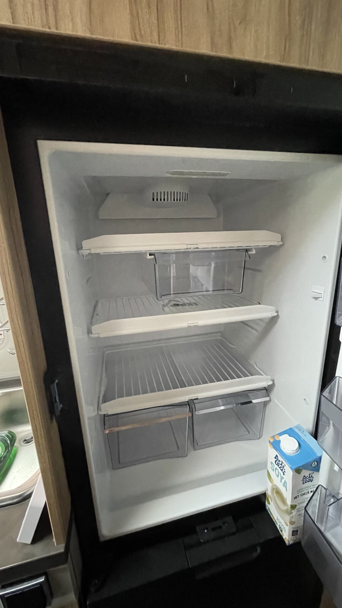

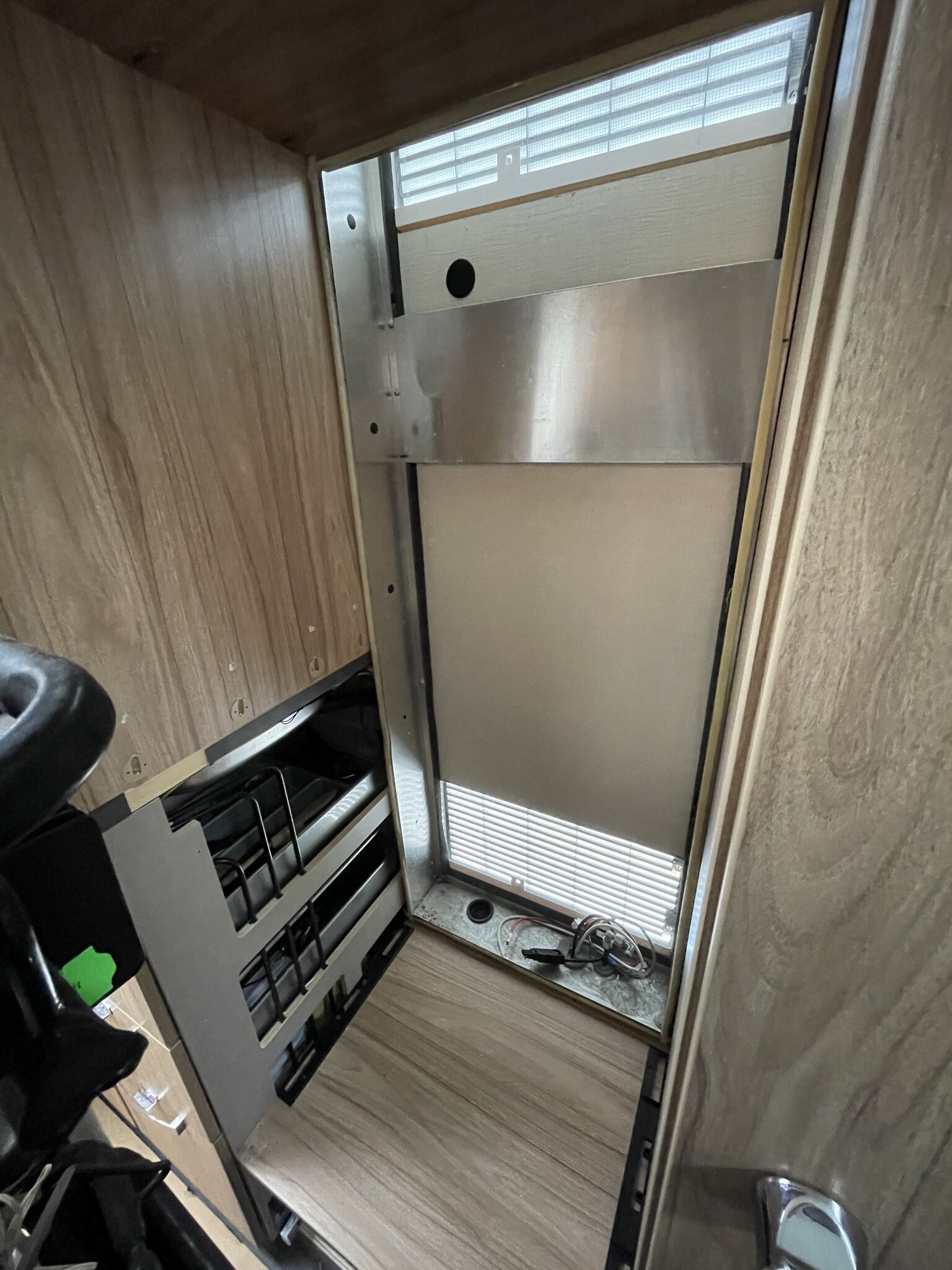

My absorption fridge/freezer is 4 years old and I’ve never been happy with it. I installed extraction fans (which worked well) and replaced the heat sink paste. Despite this I found the freezer temperature varied considerably (probably because the thermostat is in the fridge). The freezer wasn’t cold enough for ice cream or keeping some foods cold enough. I didn’t like the fridge at the bottom as I had to get on my hands and knees to access food at the back of the bottom shelf. I didn’t like the way the freezer food had to be packed. The fridge took a long time to get down to temperature and cooling was very uneven.
Well, the cooling unit at the back gave up. The cost of replacing it, assuming you can still get them (which would involve removing the fridge/freezer), was the excuse I needed to ditch the RMD8505.
I’ve replaced it with a Thetford T2160 compressor fridge/freezer. It has the same external dimensions as the RMD8505 so is a straight swap. The fridge is at the top, it has an internal fan, the interior light that actually shows what’s in the fridge and it comes with a full set of shelves (unlike the RMD8505). The 3 star freezer is a pullout drawer, making it easier to pack and access food, and it is cold enough for storing ice cream! I was concerned about the noise it might make but it hasn’t woken us up. The cost of it is significantly cheaper than the Dometic replacement (which I believe is a different size requiring modifications to the cabinet).
I wish I’d done this change a long time ago.
It uses about 45Ah over 24 hours. I have 210Ah of LiFePO4 (2 x Fogstar 105Ah), 240W solar, 30A B2B (Votronic VCC 1212-30). So far, so good.
I will be posting some Dometic fridge/freezer items for sale over the next few days.

From the installation manual.
I used 6mm² for a 4m run and Installed a fuse holder with 15amp fuse adjacent to the batteries.

Hello, did you install the replacement compressor fridge yourself? If yes, did you run the feed directly from the leisure battery and what gauge wire please. I ask because I'm in the process of doing this myself but am unsure what size wire and inline fuse to use.
I did do it myself. Hymer had already installed a suitable 12V supply as I was able to run the RMD8505 off the leisure battery with the engine off (it took about 15A), so I didn’t need to install new cables.
If you haven’t already done so I recommend reading the T2160 installation manual. Section 7 gives details of the cable size and fuse size.

Sadly I don’t have room for more batteries. I did look at how we have used the motorhome over the last four years before converting. Based on that the battery capacity should be fine (famous last words 😂).
If it was Hymer who decided to only supply me with 3 shelves then fair enough but the price Dometic charge for an additional plastic shelf is obscene and taking advantage. The mark up must be way over 90%.
Dometic also sells a fan for the fridge. Again, it is way overpriced for an item that should really come as standard.

what did you use to cover external vents?
Thanks
Easiest way is to keep the vents but just blank them off on the inside of the detachable vent grille moulding. A piece of thin aluminium cut to size and bonded in with silicone or the like. You don't need the external vent for the evaporation process as the vent for the compressor fridge is drawn from inside the van. You could simply put the Winter Covers on permanently, though you might run the risk of some thieving B taking them.
View attachment 812236 View attachment 812237 View attachment 812238 View attachment 812239 View attachment 812240 View attachment 812241 View attachment 812242 View attachment 812243 View attachment 812245 View attachment 812246
I have the same fridge it’s fantastic you can set the freezer to -6 -12 or -18 you can also turn the freezer off and just run the fridge on a lot less amps.have you tried the night setting that uses less amps and it’s near silent.
