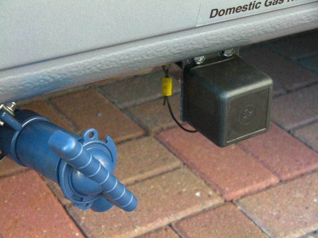

Don't forget too that you'll need a hose to go from the bottle to your regulator when you order the kit. The one you are looking at buying has the square fill point for which you can actually get a bracket to be able to mount it externally, under your bumper/side skirt so no need to cut a hole and would be able to fill it from outside rather than in the locker. Below is a photo of someone who has mounted their square filler under the side of their PVC so I would think you could do the same with your coachbuilt somewhere.
Do you think you might be able to get an 11kg one in rather than the 6kg? If so, for the small extra cost it would mean you have to fill it up a lot less. Our PVC's locker wasn't supposed to take larger bottles, but I managed to 'persuade' my 11kg Gaslow one to go in! :thumb:

Ok, mixed results:Doh: got it all fixed in , no problem , simple job four screws to hold the filler and connect the pipes , simples:thumb::thumb: go down filling station start filling up , pipe joint leaking on the filler pipe not a lot but could see gas coming out of locker, so took the gun off and leak stops , went back home had to get it out again give the pipe joint a good tightening, and went back again , ok filled up so cost me £3 for first lot and £6 for the second so £9 for a full bottle including some lost when it leaked, trouble is you can't check your joints before you fill up first time without a filler gun so it's trial and error but anyway it's up and running now.
By the way, no problem with the filling station lady , she even came out telling me how to use the pump and wasn't to worried when it leaked:Eeek::thumb::thumb:
Just to add, it was just over 12 lts in total, and it is a shell filling station.
So don't see any future problem filling up, try a photo of the setup if I get time but have to work today, so maybe In a day or two:BigGrin::BigGrin::thumb:
