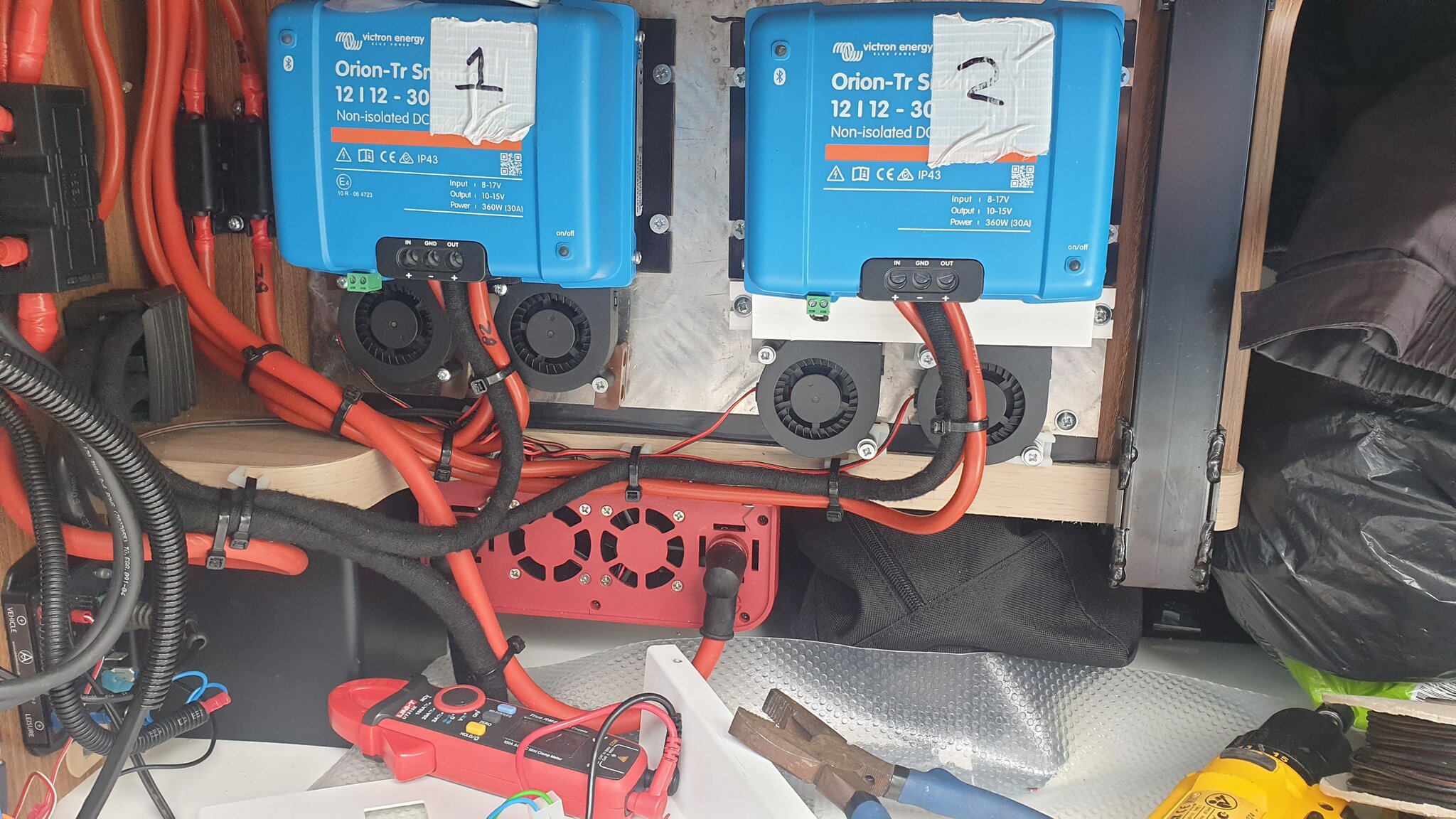

I fitted fans to ours, one has a 3d printed duct I made and the other has fans blowing straight up the heatsink. The none ducted one has better airflow and seems to run cooler according to the hand held thermometer.
They defiantly run cooler and throttle back less than they didn't have the fans on them. They seem to consistently kick out 55A between them when running so I am happy with that.

Ours are mounted on some metal plate to give a much larger heatsink. Two small laptop fans seem to cover the area of the fins nicely.
Easy job to do and we can't hear the fans when the engine is running and they are triggered by D+ signal so no manual intervention needed.
