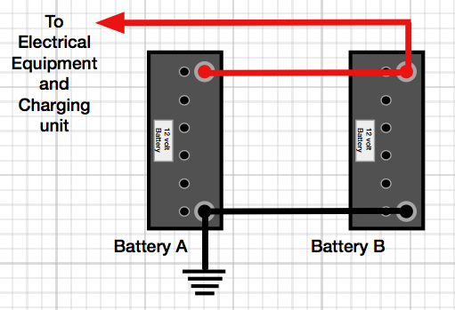

On my MH the leisure battery is in one of the internal bed boxes in a battery box.
If I want to fit a second one next to it is it just a question off
Get another battery get another box yellow plastic thing
Conect the two battery's together and the charger will do its stuff
Or am I missing something
Thanks

No you have it correct. Use wiring the same thickness as connected to your existing battery. If the two are side by side you don't need extra fuses.

Not quite as simple as connecting the two together in parallel. The main supply leads should be to the positive of one and the negative of the second battery.
In theory yes but doesn't really matter with just two batteries.
You need to check the power capacity of your mains charger. I had a Burstner and the 240V charger was designed to charge 1X 120A leisure battery not for instance 2 X 120A batteries. The fan on the 240V charger was whizzing around trying to charge the extra battery load. I fitted an intelligent Numax 20A 240V battery charger to boost the original 240V charger which couldn't cope.
Irrelevant with short leads and only two batteries. Unless using a high power inverter (which won't happen with standard wiring anyway) the batteries won't see an unbalanced current draw. I deliberately didn't mention all the complications that are introduced if the batteries are further apart, subjected to inverter loads etc, because all the OP wants to do is add a second battery adjacent to the first.
