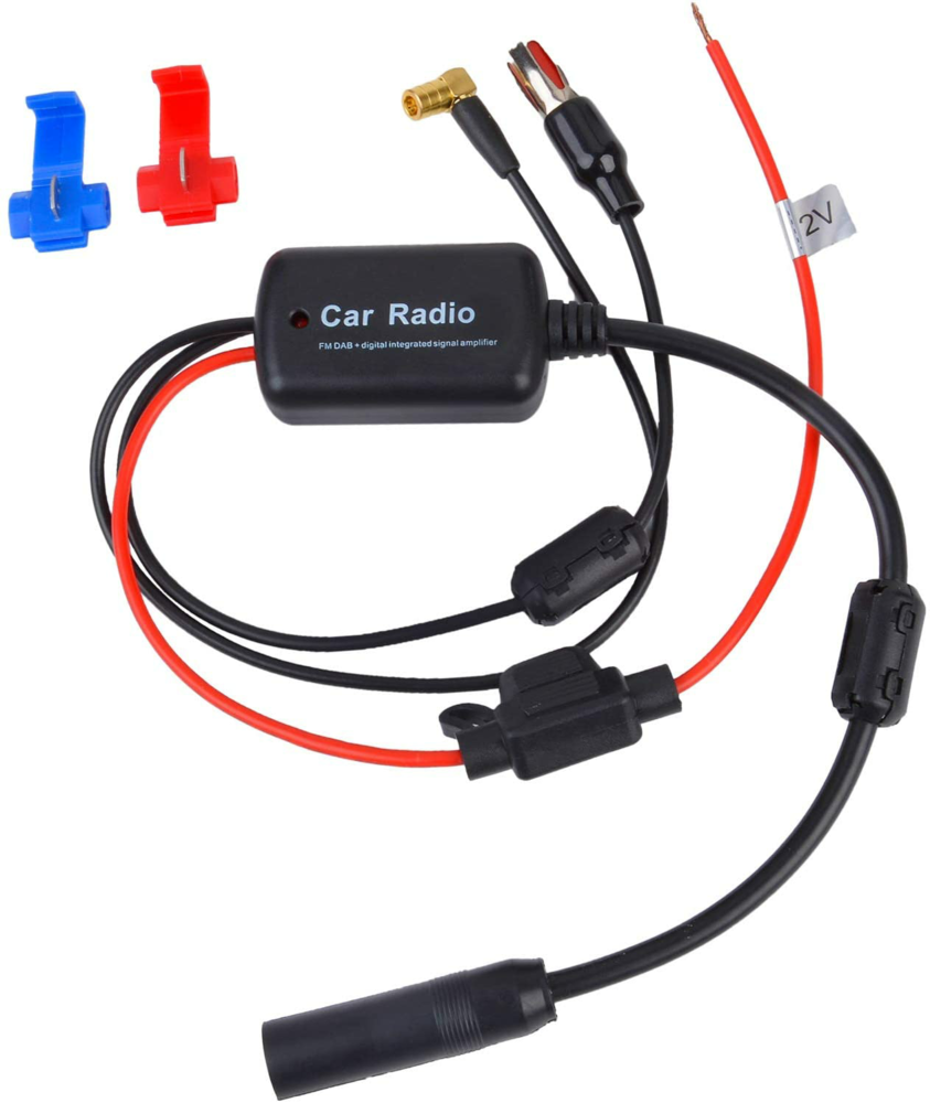

More research and I came across a FM to DAB arial booster for £12.99 from Amazon with not much faith I sent for it.
Fitted in 10minutes and switched on and up came hundreds of DAB channels.
Kit needed were a Connect2 CT23FT to fit Pioneer to my dash. Fansport DAB Arial Splitter Booster FM to DAB both from eBay or Amazon.

I doubt the aerial already installed is DAB. THE BACK OF THE UNIT YOU DECIDE TO PURCHASE WILL HAVE 2 IMPUTS FOR FM and DAB ARIALS. However you can purchase from Amazon(and others) a Fans port DAB aerial slitter £12.99 once installed lays behind the unit and is working great for DAB and FM reception. The camera connection you unplug from your old unit should plug into your new unit but u may require an adapter again from Amazon. Finally you will probably require a connect2.co.uk kit to hold your new unit in place. Loads of YouTube videos to watch.
Thanks for the quick response. I’ll probably try the aerial splitter route. I’m still curious as to where the Fiat DAB units get their reception. I’ll have to get my unit out and have a look, maybe I’ll get lucky?

My van is a PVC and has the standard cab mounted roof whip aerial with spiral winding and I have now found out they are indeed DAB compliant. It seems that a powered splitter is the solution and others have found that to work. I believe that the aerials are put in the the door mirror if the original cab roof does not exist. Research continues!
