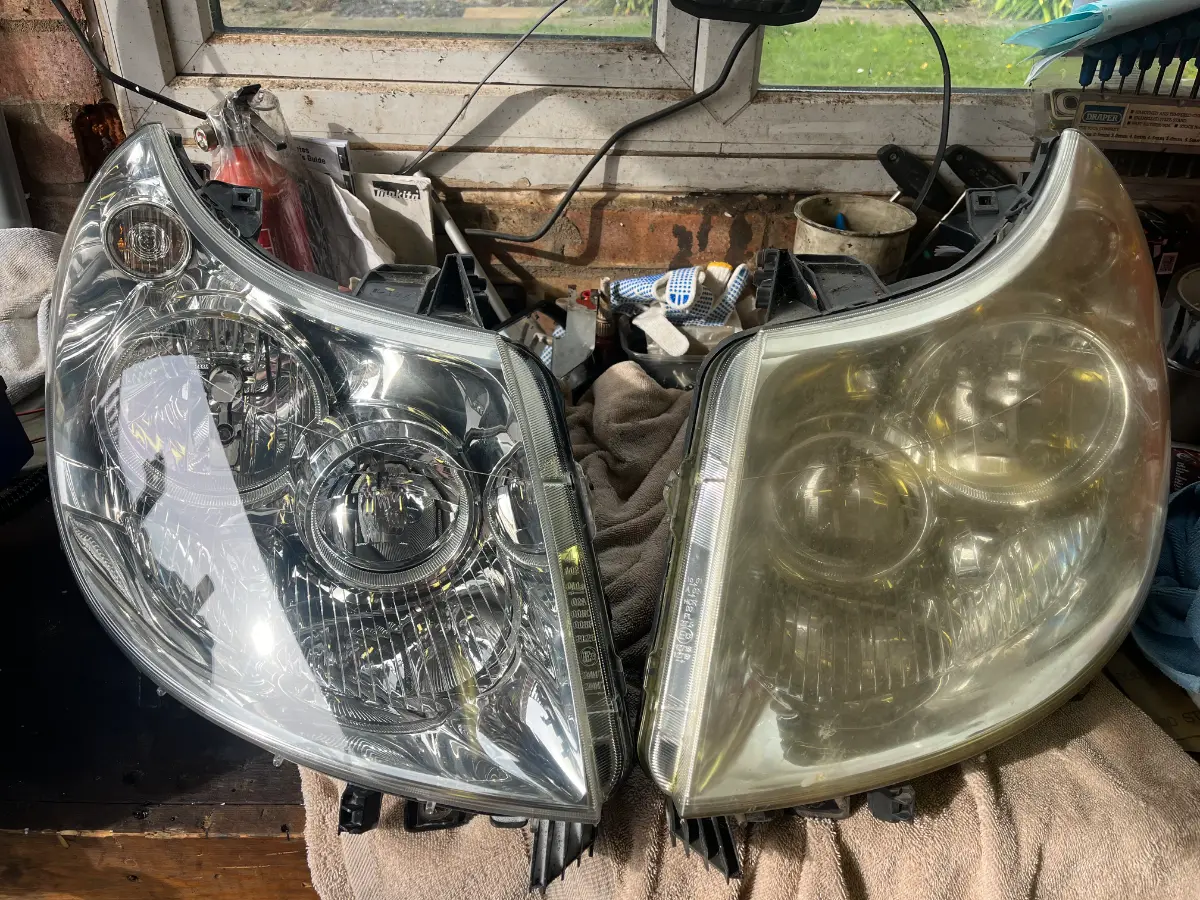

Not an answer to your question, I know. But the headlights can be easily restored.
Mine, which are a similar age to yours.

Massive difference between the 2. What did you use to clean them with???
Various grades of wet and dry, hand sand, soapy water, then buff them up with machine I use to polish van/car and some compound. About an hour a headlight I’d think.
As above if pretty bad, did the same some years ago and very effective. There’s some specialist Maguire stuff which I used on one of my cars that wasn’t as bad that worked but for another other I just used autoglym polish and that worked well.
