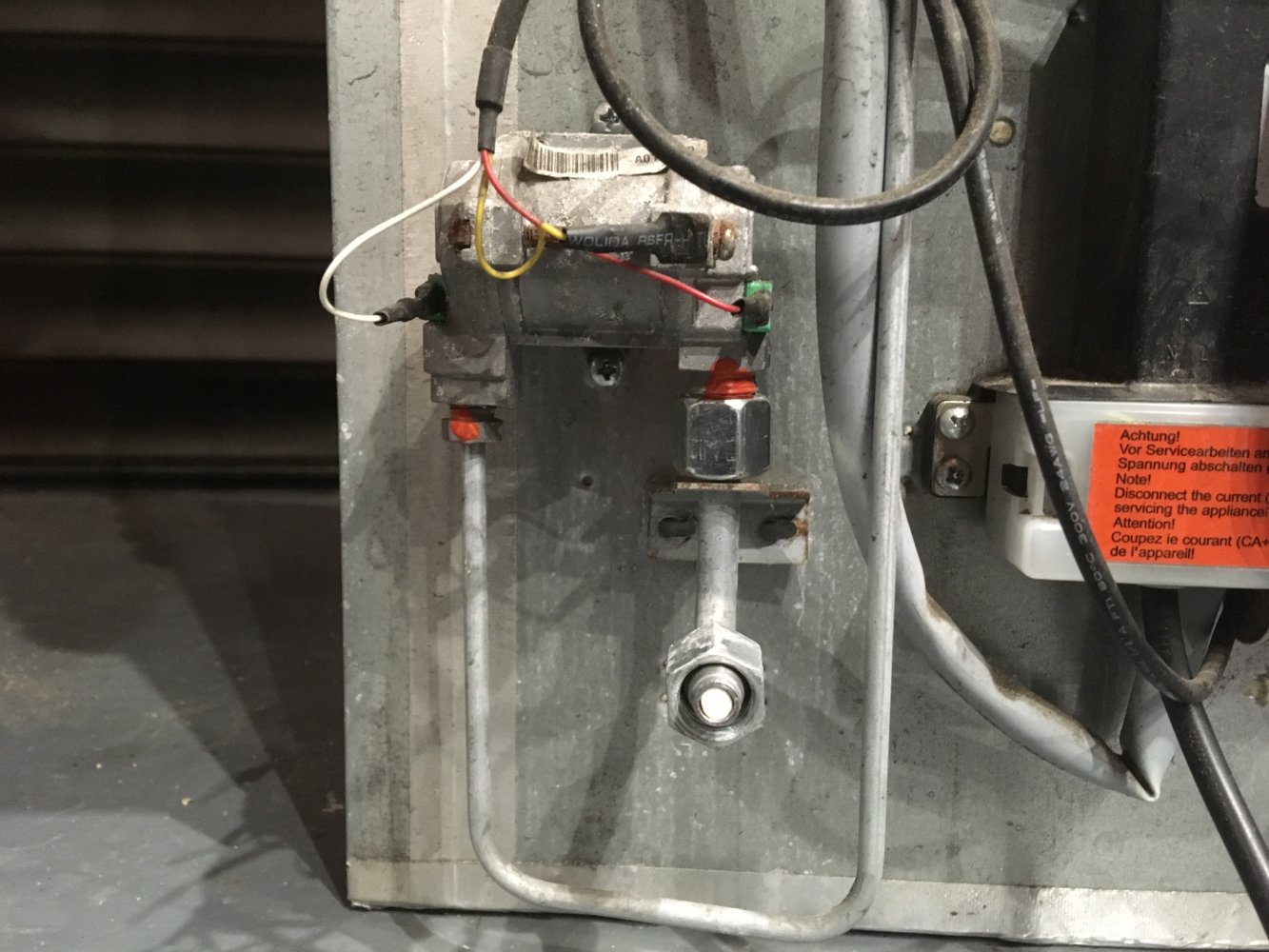

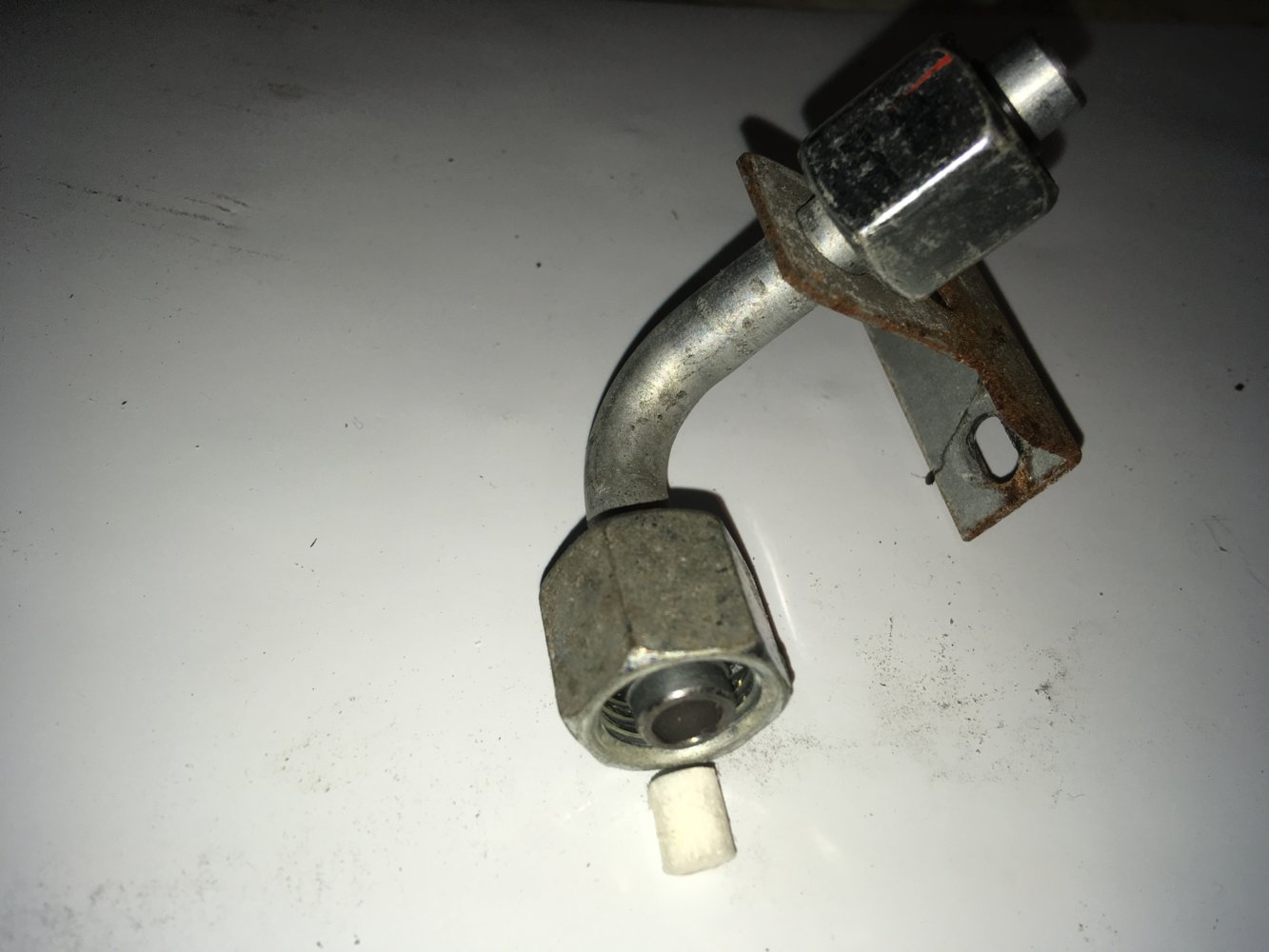

We have a Dometic fridge (RM7655L), which is driving me (us) crazy!!
It works fine on mains - freezer gets down to minus 15, no problem: On Battery, it seems to maintain a decent temperature, although we have not done any very long runs lately - been exploring nearer to home! On gas, the gas lights fine, and seems to be working (there is a decent blue flame, and the tip of the thermocouple gets nice and cherry red) but, after a few hours, the igniter starts ticking, as if the flame had gone out (but it hasn’t), the gas indicator lamp flashes orange, and the fridge shows no sign of being cooled, gradually rising to ambient temperature, which is not good!!
The flue has been blown through with a compressor and, the top end gets just as hot on mains and gas (not measured, just too hot to touch on either!). All the usual culprit comnnectors have been cleaned, but to no avail.
Apart from scrapping it and buying a new one (can’t afford that at this time), does anyone have any suggestions as to where to look next?
