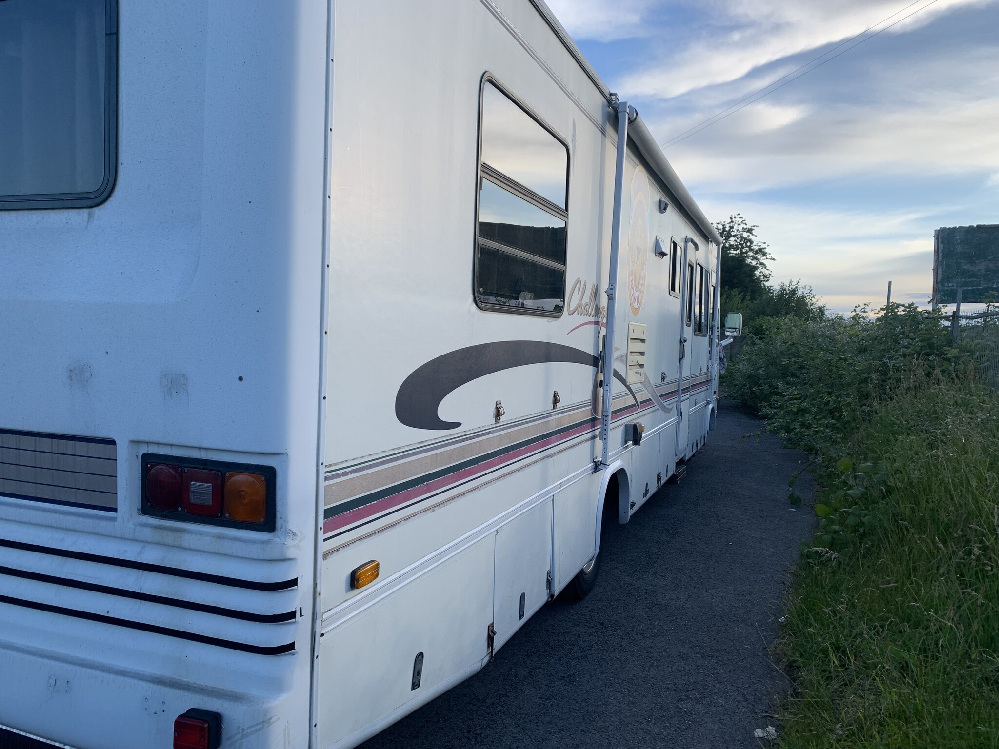

Ok her I go I stoped to help out a RV owner who was on there way to Germany for the euros
Oil everywhere fan belt had broken or so I Thaugh no problem.
But as I investigated further ie dipped the oil
It was six inches past full mark.
And very thin
I drained the oil back to the normal marks
The engine starts but lumpy.
