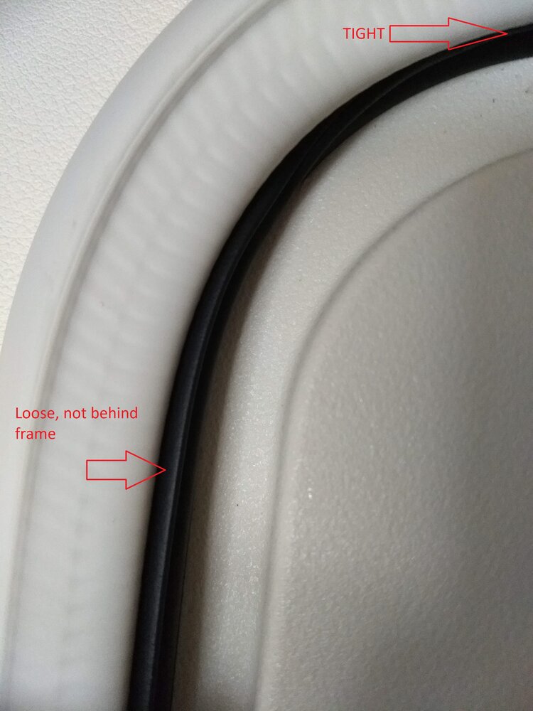

We have a plastic door mat inside the hab door of Burstner van and sometimes when visiting the van in storage there is water under the mat, no where else, though there is a highish damp reading of 25% on the bottom of the hinge side wall and under the hab door where the wood has actually rotted. We have not witnessed any water penetration while using the van. You'll see from the photos that the inner black rubber seal is not tightly compressed to the frame on the hinge side as it is everywhere else. There's no visible light getting through but pressing the seal slightly with fingers easily produces a gap. Can't see any way to adjust the door. Could it be in times of heavy rain and wind, water is pushed in and on reaching the bottom is trapped and so spills over inside or something? Are all hab doors like this? Thanks for any input!

There should be adjusted on the hinges , Had a similar problem with a Hartel door with wind but no water
Current MH has a seitz door no problems

we had the same problem last year and were racking our brains as we had not had any water in van before. Our door mat was almost floating and whenever we dried the step more water appeared. Fingers crossed we think and hope we solved the problem. The rubber seal on the right hand external side of the door has a join near the lower hinge. This had popped out of position and was acting like a funnel everytime it rained. Just pushed it back into place and we haven’t had any water in since. We do keep an eye on it, but so far so good.

Yup, adjust the hinges.

We tried all these things but was just simple pressure with finger popping rubber into place.
That’s terrible on our Hymer the door seal is actually on the outer edge and fits snugly to the door it’s a double seal as you can see😊
We used to have an N+B Arto and I noticed that there was a seal on the door and also on the doorframe simple or what .
Can the door be adjusted?
Are the seals fitted correctly?
Thanks for reply. Cant see any means of adjustment and seal fitting round the door looks correct

Yeah, I really need to do that but no water source at storage place unfortunately.
I cant see any obvious means of adjustment and the door looks to be central in the opening. Do you know what the adjustment might look like? Ta

Thanks. I have seen that done on a fridge and though I haven't tried it on hab door yet, am quite sure that paper won't be gripped at any point down the length of the hinge side since the seal is not compressed to the frame as it is round the other 3 sides. Instead it's simply touching against the frame. Now perhaps that's not where water is getting in, but if it is I cant see any means of adjustment. Cheers for the reply!
Okay, what I thought but not put down was this, if the paper can easily slip between the door seal and frame, and be shown to slip between, then point out to the dealer whom you bought it from, and tell them that if you can slip a piece of paper between as you can demonstrate, then that shows you have a weakness there that can easily leak and you have water ingress. And ask them what they can do about it.
I bet they faff about saying all sorts of things, but these are trade excuses, they may try and build out the seal to grip better, but, if your door is a unified unit, it may have to be replaced.
So, if your vehicle is under any form of warranty/guarantee you may have a claim.

I wish it was but long since expired unfortunately. Thank you for your input and I'll definitely give it the paper test anyway to test the efficiency of the seal.

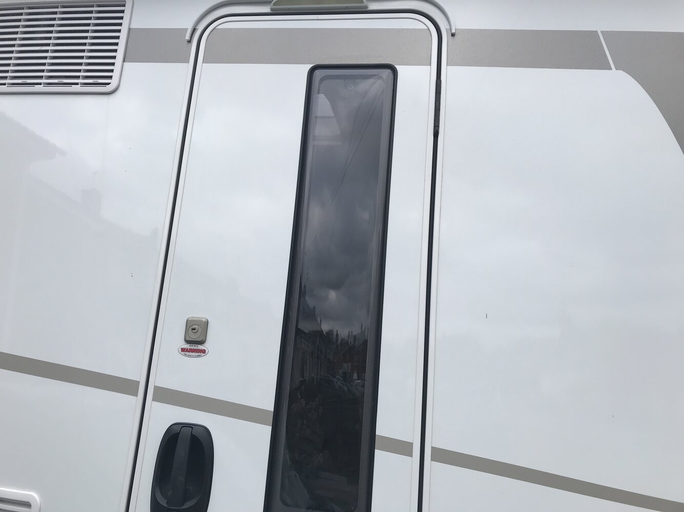

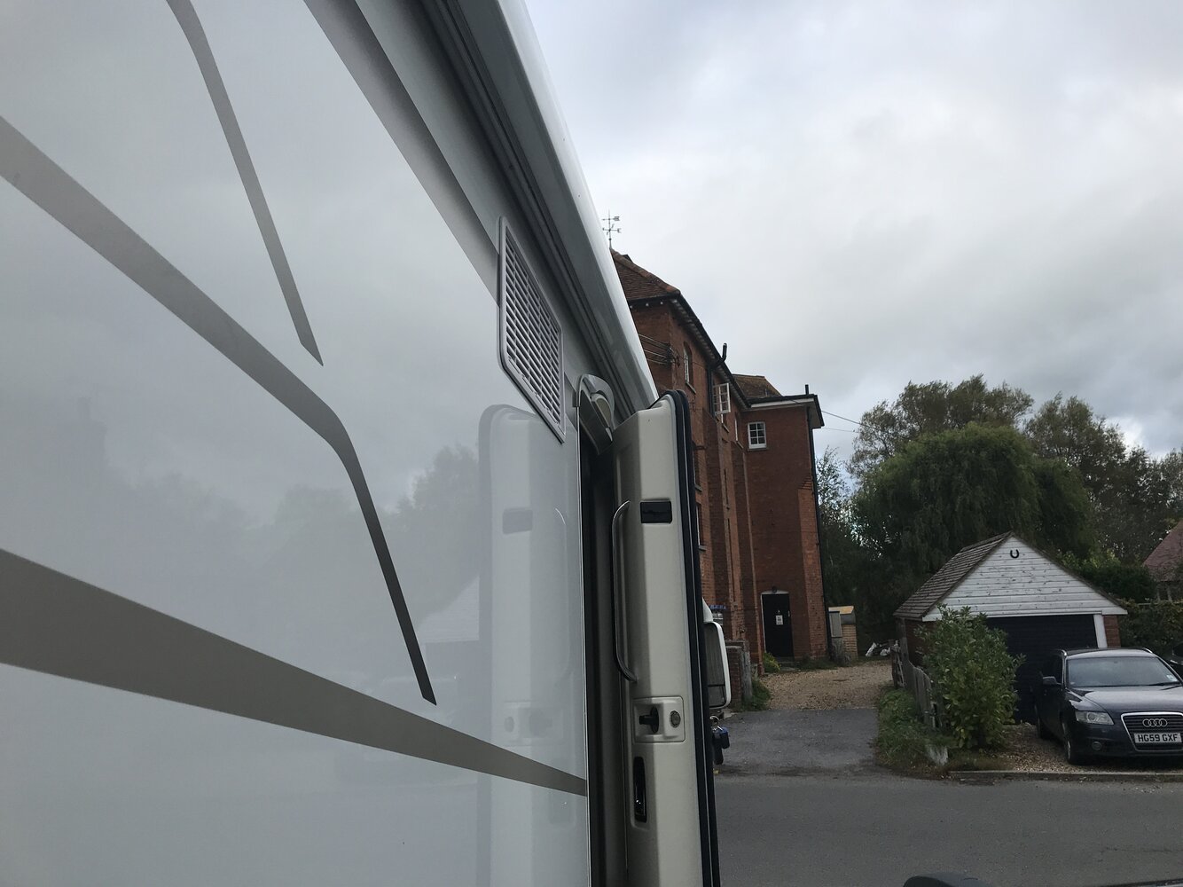

I had a similar problem with an A class Burstner, the problem was resolved by fitting a small length of trough (rain deflector) above the door to divert rainwater away from the door seals.
Speve’s 2nd photograph of his door shows the ” rain deflector” or troughing above the habitation door.
I mentioned this to my Burstner dealer, that is, Chelston’s in Taunton, and they were able to resolve the problem, which is no longer a proble!
Worth a punt! I appreciate the heads up. Do you happen to know what the deflector is exactly or where to get it? Ta
I don’t know what it’s called, but Chelston’s and Newport caravans are familiar with the item as they have fitted the “ rain deflector” to my Burstner A class.
In conversation with the dealer, I was of the opinion that they are aware of this scenario.
Have a go, it’s worked for me, twice!
