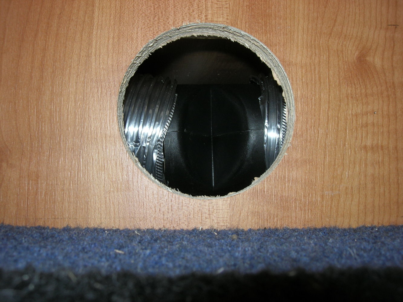

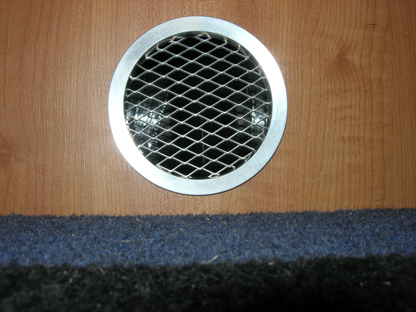

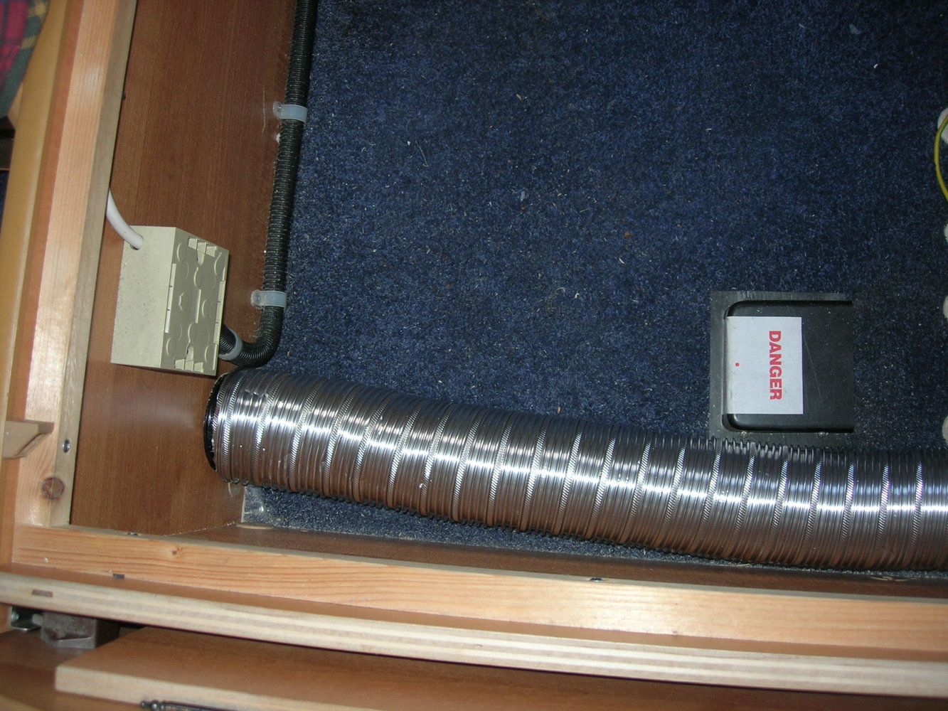

An outside locker lent itself to where the heater could live, it backs on to a cupboard inside which has a 5" gap under it, good for routing the hot air duct's under, access a little tricky but with a bit of thought where the outlet hole's were drilled & the return air hole went I could get my hand's in to connect it all together. I slide alloy ducting over the black tube to help insulate it,
Its work in progress not finished, some stuff is temporarily fitted OK
