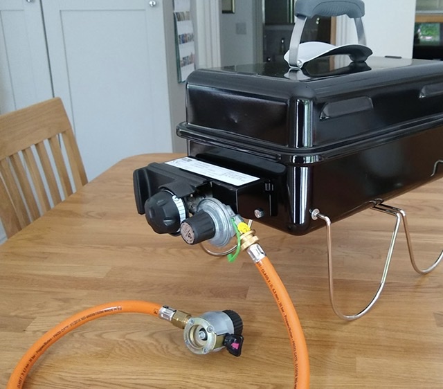

The reason that we’re using a Patio Gas bottle for the BBQ, is that the Weber connector pipe for our BBQ has the Weber screw connector to fix to the BBQ at one end, and at the other end it’s got a push-on adapter to fit onto a patio gas bottle. (See photo below)
I took the connector to our local Calor Distribution Centre, to see if it would be possible to change the gas bottle adapter end to fit a regular Calor Propane bottle (so we could run the BBQ from the Calor Lite bottle), and he said it wasn’t possible, so that’s why we went ahead and bought the Patio Gas bottle.

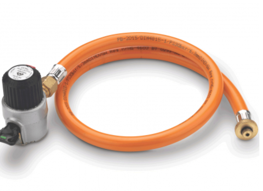

Not sure of the threads on the BBQ but could you not source a tail like this and run it off your calorlite bottle.
Talking out of his rear end.
Hi GC!
Thanks very much for your reply and the link. I’m afraid that the BBQ end doesn’t look as though it is the same connector as the Weber end - here’s a picture below of the connector:
We have tried to get the Weber end connector from Gas Fitters / Suppliers (online and local) but we had no luck, and the advice was to cut the end off the Weber connector hose, and use it to make a new connector to use with the Calor bottle, although that’s not something we have any experience of so wouldn’t be able to do ourselves.
Just had a look and it would seem you use a 50mb reg on that type so a spare bottle would be the best way to go 👍
