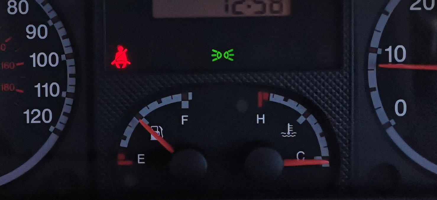

I have had a niggling problem for a couple of months with the Bulb failure warning light on our 2010 Fiat Ducato based MH.
I have repeatedly checked all the lights were working but the warning light persisted.
This morning I thought I would have another look at the lights and because the back of the MH was in the shade, I noticed that the N/S brake light, although working, was not as bright as the O/S.
Took the light cluster cover off, removed the brake light bulb, noted the type of bulb, found a new like for like replacement in my stache and noticed the original bulb was a little darker...
Then I thought, why does a brake light bulb need a double filament?
Removed the O/S light cluster, checked the brake light bulb and found that it was a single filament/single contact bulb. Found a new identical single filament bulb in my stache, fitted it to the N/S, restarted engine and lo & behold, warning light was off!:party3::clap:
In my 4 yrs of ownership I have never been inside either of the light clusters so I can't have put the wrong bulb in!
The warning light has only been on for a couple of months so what has caused it to come on I have no idea?
