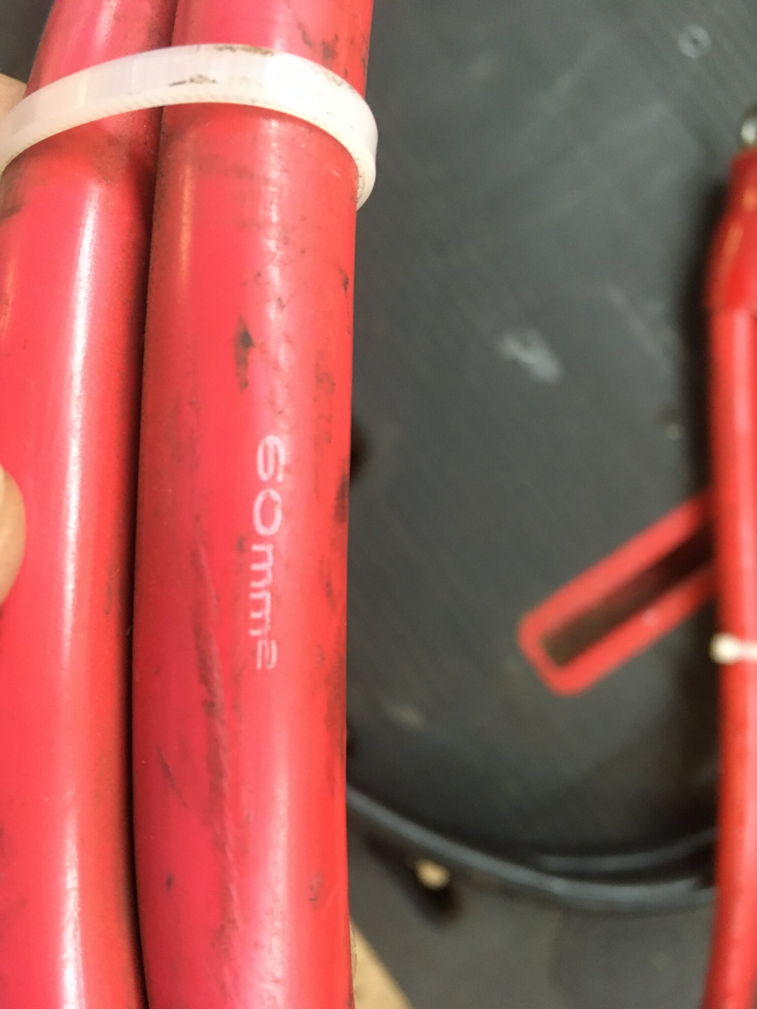

Now have the new solar panel and mppt controller fitted and all seems well.
Next issue was the battery to inverter cable and I went up this afternoon to my local auto electrician to get ones made. Note to self don’t ask favours on a Friday afternoon! Anyway although too busy to make exactly what I wanted, did give me the attached two cables which he said would do the job. The cables are 60mm2 each so 120mm2 per lead. My query is should I cut one of the cables off so it is just a single 60mm cable or just leave them as they are?
