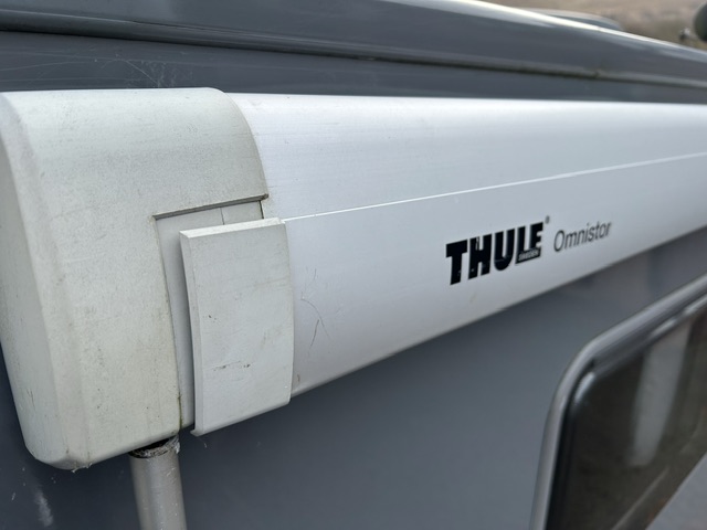

I’ve had a problem closing our awning fully for a while now so time to have a go at sorting it out(only taken me a year to get round to it🙃)
Photo 1
gap from above
Photo 2
Added multiple layers of duct tape (wind awning fully out , add a few layers ,in to try ,back out add a few more ,in ,out shake it all about👍)
Photograph 3
Success 👍
just have to see now if the sun causes a problem with the duct tape.

It looks like the arms may need adjusting in the track.
There is a cog at the end of the awning case accessible when the awning is fully wound out. You have to wind it back with a screw driver . Google it and videos come up.

Looks like the mechanism needs adjusting.
Arms either need adjusting or one could be bent, or I’ve even seen the cables had been overstretched. Usually the arm at the opposite is the issue.

I used two pieces of gaffer tape, about 3 inches long.. . awning now winds in fully at both ends..

That’s what I did👍
Hi there
I don't know if this solution is for your problem.
I had one end of my awning not going back in properly.
On the ends of the the awning when rolled out just above the support legs, mine had reflective stickers on the cap ends, they were cruddy and worn.
I peeled them off, sanded them smooth with fine grit sandpaper and cleaned them .. and a little smudge of white silicone grease. It worked a treat.
I think the resistance of the end caps was just enough to stop it going fully home; because the tension on the last bit of handle wind was where the retraction force was weakest.
Try cleaning the end caps, smoothing and a tad of grease.
It may do the job without tape, I hope it works for you and it is easy peasy to give it a try .. GOOD LUCK
Loads of tips thanks 👍 but mine is ‘fixed’ now🙂
