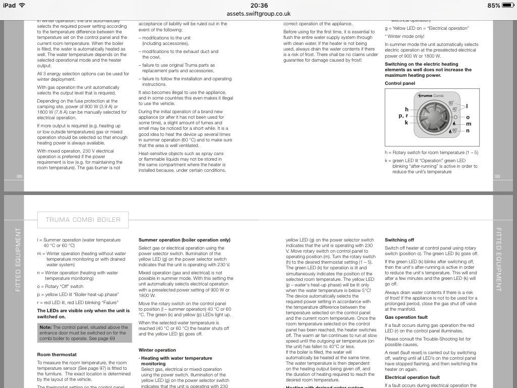

I am not a Truma expert and I don't know the control system in the photo.
But if you are running just on Electric hook up the Truma will only run on about two kilowatts of heat. I doubt at -1c that would keep the van warm.

No expert but I think you've set the dial to heat the water as well,setting 'n' gas symbol and 60 for water so it won't blow hot until the water is at 60 which it will never be as their isn't any.Should be just on 'm'

Also just spotted the dial setting - change it to heat only (anti-clock one click, the flame symbol).
rb62, your more of an expert than you think. Great, many thanks for the instructions. I have made a copy and yes it does appear I was running on winter water and heating. I have switched to the correct setting. I will now wait and see if it makes any difference. I do appreciate the effort you have made. Once again, many thanks.

You have control set to the wrong setting, as so it is trying to heat a dry water cylinder as you have drained it. You won’t get much heat whilst in this setting as the system always prioritises hot water over heating. But it can’t get the water up to temp, because you’ve drained it.
