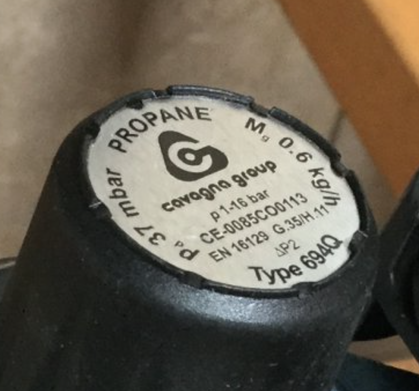

It looks like the Weber Go-Anywhere BBQ uses a Cavagna 694Q regulator, but I can't find any information on the connector from it to the BBQ gas valve. If the regulator can be removed, then we could advise on a replacement fitting into the gas valve and suitable hose.
Weber Go-Anywhere Cavagna 694Q regulator

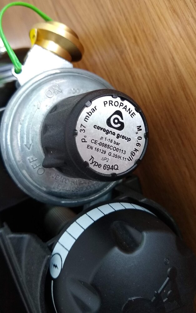

Hi everyone, thanks very much for your replies and advice!
I've checked the regulator that's fitted to the BBQ - as per your post JA, it's a Cavagna 694Q - here's a photo. I've had a look to see if it would be easily removed - see photos further down, but I suspect it's not going to be straight forward. I can't see what the type of connection is that connects the built-in regulator to the BBQ....

You need to separate the regulator from the gas control knob, which feeds in to burner tube. If you look at he second photo you can just see a furled nut, which is probably connecting the two parts. Undo that and I suspect that you may find that the hose that wanderer is selling will fit on it.

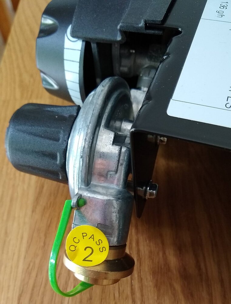

Hi everyone, thanks so much for your interest and advice!
I've had another look at disconnecting the regulator from the BBQ and it looks like it's going to be quite tricky. I wanted to disconnect it so you could see what the connector was from the BBQ-mounted regulator to the BBQ Control knob.
Instead I've taken another photo from underneath which shows the connection better - I don't know if this gives you a better view - to judge whether it's worth pursuing?
March Hare If it is the same as the gas control valve on the Weber Q1200, then the fitting is a 0.25" BSP left hand thread. You would then need one of these from Huddersfield Gas to go on to it https://www.huddersfieldgas.co.uk/product/quick-release-connector-1-4-bsp-fits-most-cadac-weber/
This is turn would connect to the female half of a 8mm quick connector and then 8mm gas hose to whatever regulator you want to use (or onto your van).
If you want to remove the existing regulator or connector it really needs to be done in a bench vice remembering that it will likely be a left hand thread (it is on the Q1200).
Note that Weber use 6.3mm hose on the short connector for the Q1200 so unfortunately this needs replacing if you end up with one as I never found an adaptor for 6.3mm -> 8mm hose.
