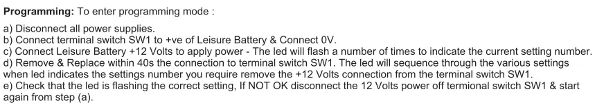

It's not explicitly mentioned in the manual but I believe applying 12v to SW1 disables the charging.
Edit: Actually, it is mentioned in the manual!
But won't that screw up the programming.
I have fitted a NC push switch in the negative cable so I can restart the BT dongle, when required. Works for me, so would a relay do the same job but automatically, assuming it's correctly connected and is not something I will be exploring, just an idea.
I know that but knowing what a pain they are to program I wouldn't want to risk it.

Yes not sure why they bothered with the smart settings - but pretty sure that being able to switch it off when the engines running is what the SW1 is all about, just to preserve the OEM smart syatem.

As an update about use of the SW1 terminal to disable the trickle feed when a 12V supply is attached, I Emailed Ablemail about it and received the following:
Hi
Sw1 is not needed . it was something we built in and then realised we did not need.
We monitor vehicle battery voltage and disable trickle charging if vehicle batteries high(engine running),
So all good on the SW1 front, no need to connect to an ignition source.
