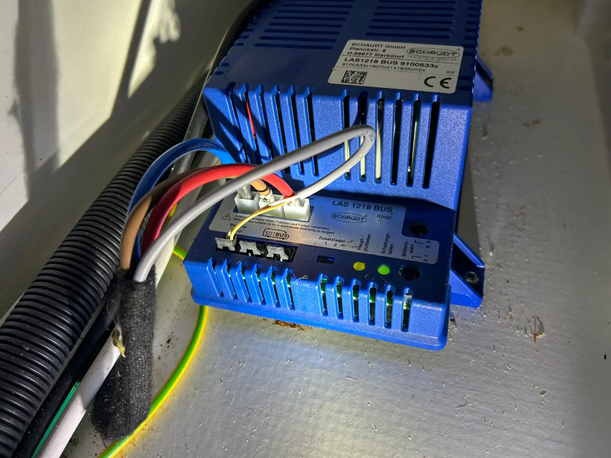

Could it have tripped something in the vehicle - have tried switching off and on the consumer unit, they were not in the down position, is there another electrical supply trip somewhere? There is a blue electrical looking thing by the consumer unit not sure what that does. Hymer 675.
