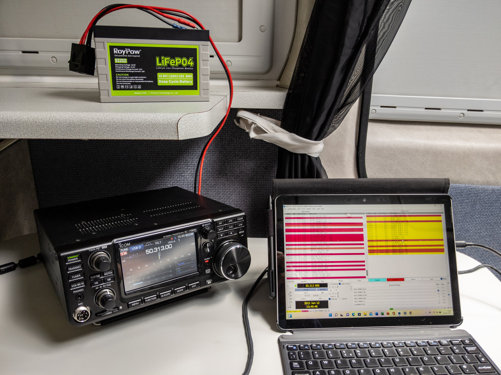

I did a first test yesterday running my Icom IC-7300 off a battery in the MH. Its only a 12Ah capacity but I think it will run it for a couple of hours or more if I wind the power down to 40W or 50W. At 100W it draws about 17A and the battery is only rated for 12A continuous current. After about 45 minutes of use the voltage, which was over 13V on receive was dropping to 12.5V on transmit with a current draw of 7A. The IC-7300 is supposed to be able to run on 12V so it could have run on for longer. However, I intend to add a small voltmeter into the cables so I can monitor the voltage as I suspect it might cause damage if it dropped below 12V.
I've previously used my IC-705 from the MH but as that only produces 10W it can run for much longer off a small battery.
In theory you could connect the radios to the MH 12 volt system but I am worried about RF getting into the CANBUS and causing expensive havoc! It seems much safer to run it from a completely isolated supply.
