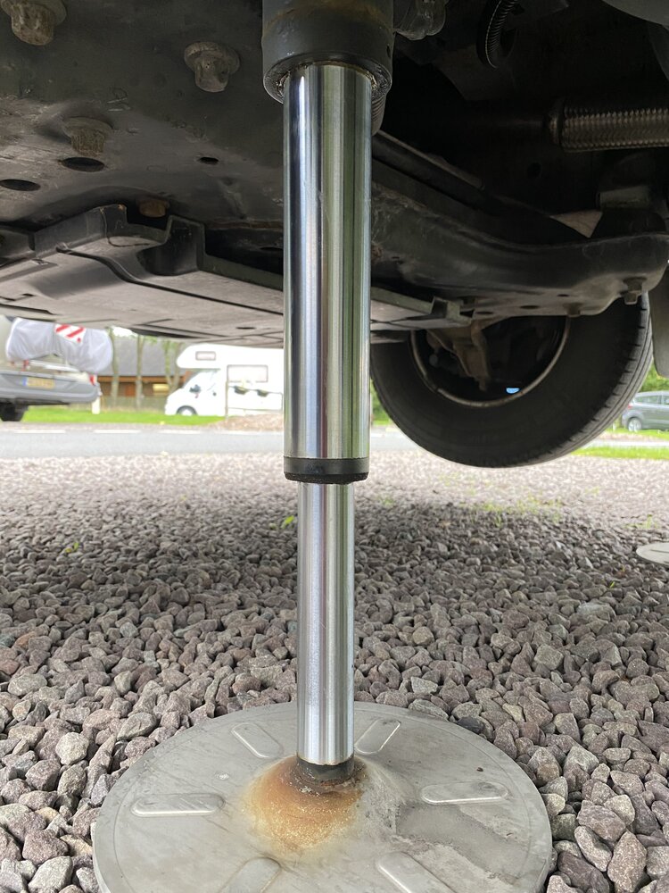

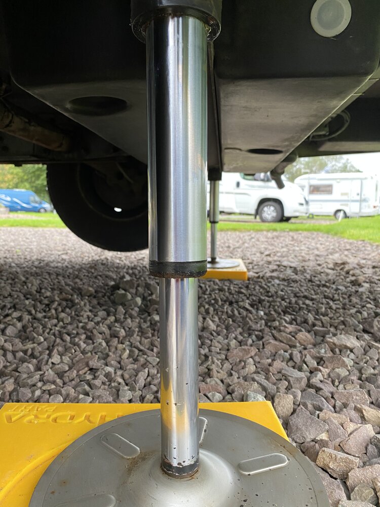

Techno
Deceased RIP
Jul 28, 2010
15,475
20,756
Leeds the one up North
12,905
Rapido 7090F 3 litre 160
May 2010
This is a front leg and both rams have machining marks so definitely turned from solid stainless. No corrosion at over 4 yrs old
This is a rear leg and the primary ram is machined stainless with no corrosion but the inner or secondary ram is chromed steel and corroding.
