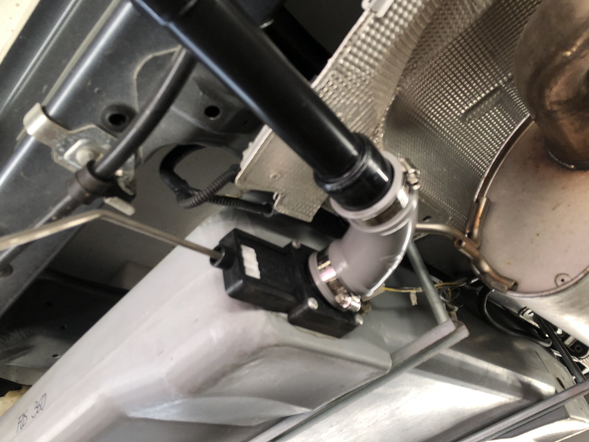

Hi, I vaguely remember seeing a thread about this some time ago but can't seem to find it. We have a 2007 CI Mizar, the waste tank outlet is a way back and can be difficult to position both over a drainage point or if using a bucket to empty. I'm sure I saw someone had used some plastic pipe to adapt this so that it dumped to the side, has anyone got a picture and dimensions of the piping needed please?
Thanks
Mike

£15.68p for one of these from Screwfix. Once fitted onto your current waste discharge point you can then shove in a 40mm solvent weld piece into the open end of the elbow and you're free to create a pipe design to suit your vehicle
Thats black 40mm floplast solvent weld pipework from Screwfix. Cheap as chips. I reduced it down to 32mm using their 40mm x 32mm reducer, just because i use a wastemaster and the 32mm pipe discharges easier into the wastemaster opening.
I just use a push fit 40mm hose cut into 1.25m sections and joined by CAK Tanks hose joiners HFTJ040 40 mm. Hose sections store in a bag under the floor in the full width storage locker. Recently invested in an RV waste "slinky" hose which (although pricey) works very well, no more stones and bottles to support the hose. :giggle:
