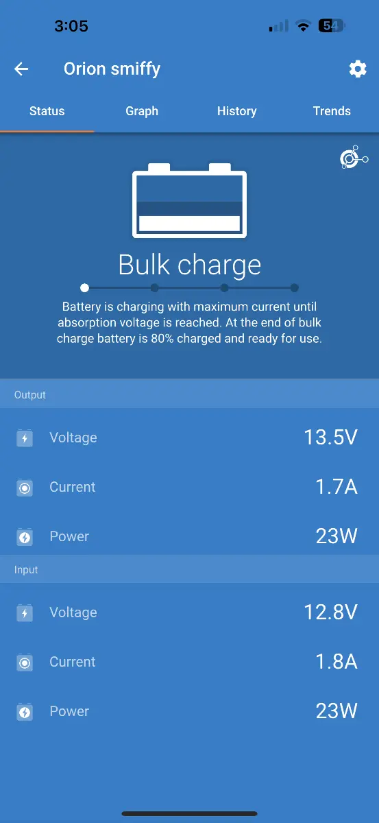

I have one and have just yesterday replaced my 2 gels for a eco-worthy 280a lithium. It worked ok when I was running fine with it on the gels, although only set to 30a
I have changed the victron solar controller to life-po4 and the b2b to the settings that RogerIvy gives in his video on the b2b I have a regular alternator.. when engine is started it runs around 3 amps and is now down to 1.8a 24w
I have 16mm cables positive coming from the vehicle battery to the b2b and the negative from the bad going onto the bus bar near the lithium battery.
Any thoughts …?

Just tested the cable going in to the b2b and getting 3.00a from the b2b into the battery is 2.7a tested on positive cable

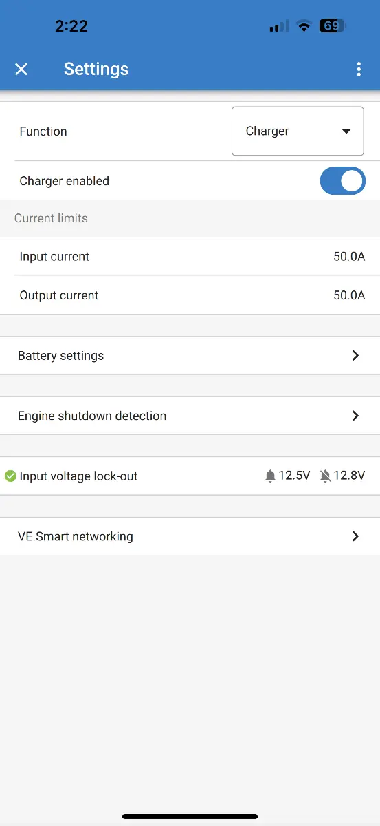

Not sure but the user defined engine shutdown detection looks odd. Try the standard Victron regular alternator setting. With a Fogstar mine is start 14.0v, delayed start 13.8v, delay 120s, shutdown 13.5v. Seems to work well, although rarely get 50A as the fridge and stuff pulls a bit.
Oh and check your firmware is current on the Orion. See the cog settings and product info in the right 3 dot drop down.
It was the same on default that’s why I changed the settings to what OGS recommends…🤔

As you have Solar you need to use the D+ to switch the B2B and turn the Engine shutdown detection off, it will never work reliably without using the D+.

If you have a smart alternator then the problem is probably your Alternator Settings. The 12.8V shut down voltage is too high for a smart alternator which is trying to keep the engine battery at about 12.3V. The shut down voltage is there to make sure the engine battery is not over discharged but it needs to be much lower for a smart alternator.
I know this because even with D+ activation my Victron OrionXS didn’t work all the time. It was fine if the van had been on EHU which raised the Volts above the 12.5V mine had been set to by the installer but at other times it simply did not work. I spent an hour checking voltages fuses and D+ signals before stopping to have a good think and go through all the settings. I dropped the input voltage lockout to 12.0V and the restart value to 12.3V and “hooray” it switched on and started charging at about 48A. I will have to try it on a few runs to be sure I have got this sorted but it all seems to working and it makes sense that the cut out was to blame because it overrides all the other activation procedures.

If post 11 shows the b2b with the engine running, the starter battery is only on 12.8V, the same as the engine shutdown voltage setting on the b2b. Would this cause problems? Does Garry just need to put a foot on the throttle 😖 ??
