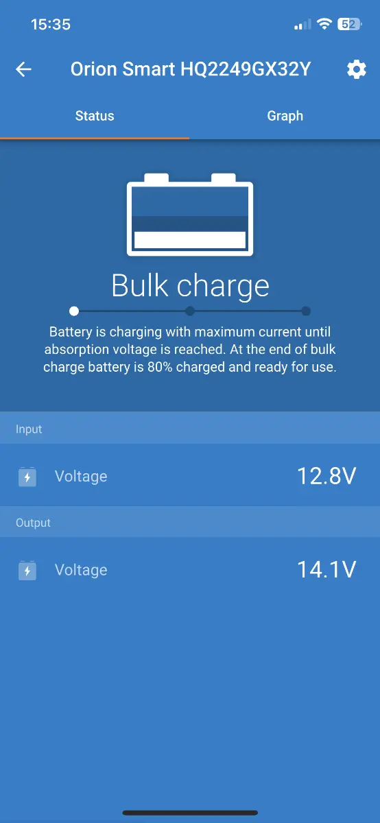

My next bit of confusion is the dc-dc. It always seems to be in bulk charge. I’ve got a vanbitz battery master connected to it that always seems to be trickle charging the van battery too (red light on).

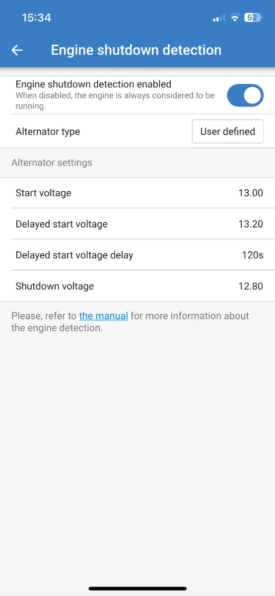

I’ll post pics of what my app says and the settings I’ve got. But it doesn’t seem right to me. Any advice?

You have the absorbtion time set to 2 hours so it will stay at 14.2v for hours after the battery reaches about 95% before goint to float voltage. Maybe you are not driving for long enough for it to change to float.
You could try changing the absorbtion time to ½ hour.

The Victron 30a Orion tends to run hot does it not? It then throttles the output, so your batteries may not be getting enough current to fully charge, especially if there are any current draws at the same time
When I felt the DC-DC yesterday it wasn’t hot at all, but the battery master was very warm!!
Is the battery master charging at night and is the DC-DC in bulk when the engine is off? My 1st thought is that you have a voltage loop through the battery master. Your starter battery is at 12.8v and leisure at 14.1 so the battery master is on as the 2 voltages difference is above the BM trigger which I think is 0.7v. Your DC-DC shutdown is also at 12.8v so If your DC-DC isn't switched by D+ then maybe that's why it's always on. P.S. I'm no expert!!
