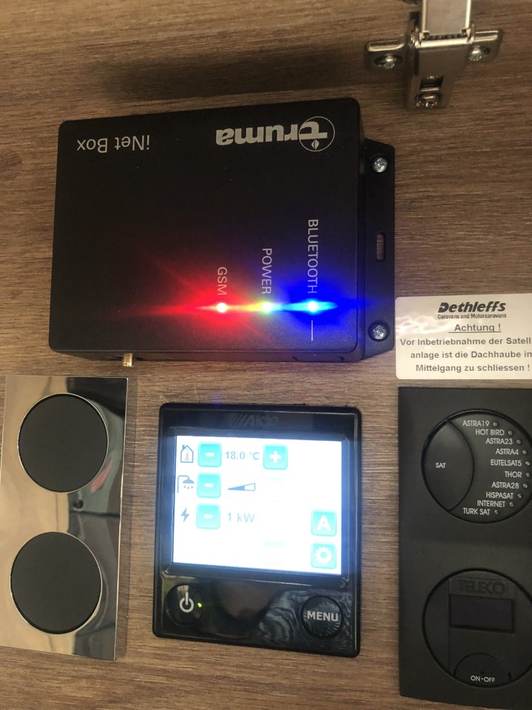

Dealer just fitted inet box to my van , with intention of using the Truma App to operate the heating and hot water etc.
The 3020 panel states its inet ready so I thought I’d have it. I also intend to fit aircon in the future and link it to the inet system.
Having got home I’ve loaded the Truma App , set up the Bluetooth and inserted the SIM into the inet box. Followed the app set up system and all worked ok.
All seems to set up ok with Bluetooth and the gsm.
Problem is the app won’t detect any devices so despite it all being fitted and set up I can’t actually use it to operate the heating and water as planned.
Power is connected to the inet box and there is also a cable connected to the “Tin” socket on the box.
I attach a photo
Anyone got any experience of fitting or setting these things up. Am I doing something wrong ?
I’ve also emailed Truma and the dealer but thought there might be a funster out there who can help
Thanks in advance

I wonder if they have plugged it in the wrong way as your iNet box is next to your control panel where as mine is next to the boiler itself as this is where it needs to be connected to, see post above.
I am a bit confused (as usual). The photo shows you have an Alde heating system, not a Truma. Can a truma box work with the Alde system?
It can indeed but it doesn’t connect to the control panel like the previous alde smart device. It actually connects to the boiler in the spare tin port then back to the inet box. From the pic attached unless the boiler is next to the control panel I would say they probably connected to the tin port on the control panel instead.

Despite being told by the dealer that they connected the inet box to the boiler , it turns out they did indeed connect it to the Alde panel.as some have said , this is wrong . Van back with the dealer having it correctly fitted !

I was hoping they hadn’t but they put the inet box right next to the touch panel which unless your boiler was near there was little chance it was correct. I would be worried to let them near it again if it were me as they should know this if they were competent. If they had done that to Me I would be very peed off as my control panel is in full view and having 4 holes on show would not go down well. Hopefully yours is hidden
