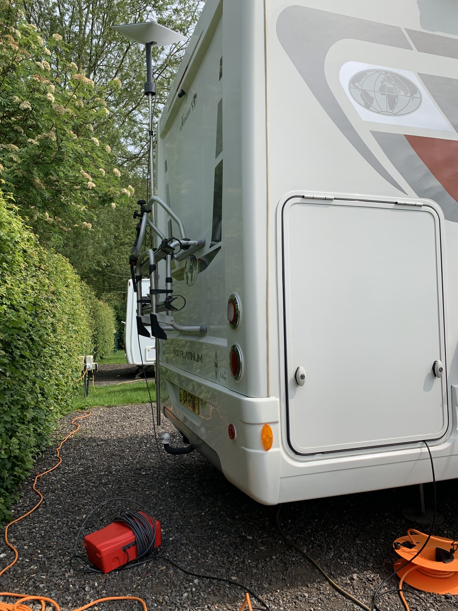

This is mine. Made for deployment on-site.
New version with box.

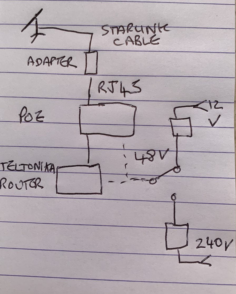

It's working on the bench at home! I used the kit in my previous post, and it arrived fairly swiftly.
I use a Teltonika router that runs on 48 Volts, so I didn't have to put in a new 12-volt power for running off the mains.
This is the adapter and POE injector (I see they are not in stock at present). There are a few alternatives if you trawl the Internet:
  1. A POE injector for Starlink (they have to be about 150W),
  2. A Starlink cable to Ethernet Adapter.
I used the plug-in adapter as I didn't fancy cutting the existing Starlink cable, as some have reported issues with this with bad connections and earthing issues. It's very easy to adapt as everything is in the dish on 192.168.1.1 - and the Starlink external box is just a WiFi AP and power supply.
It is a dual power 12 volt and mains box, using a small step up for the 12, and a small switched mode for the mains (the unlabeled boxes below). You can easily add an ethernet connector to the van, but I just connect to the WiFi from my internal router.
I'm still not convinced that there is enough power to run on full motor and snow mode - but you can disable the heating, and it seems to idle at about 40 to 60 watts on 12 volts. When I finally get it in another box and looking smart, I'll take another picture or two, but at the moment I'm just using it on mains hookups.
There is a very crude diagram below - still on the road and can't do anything fancy!
Cheers
