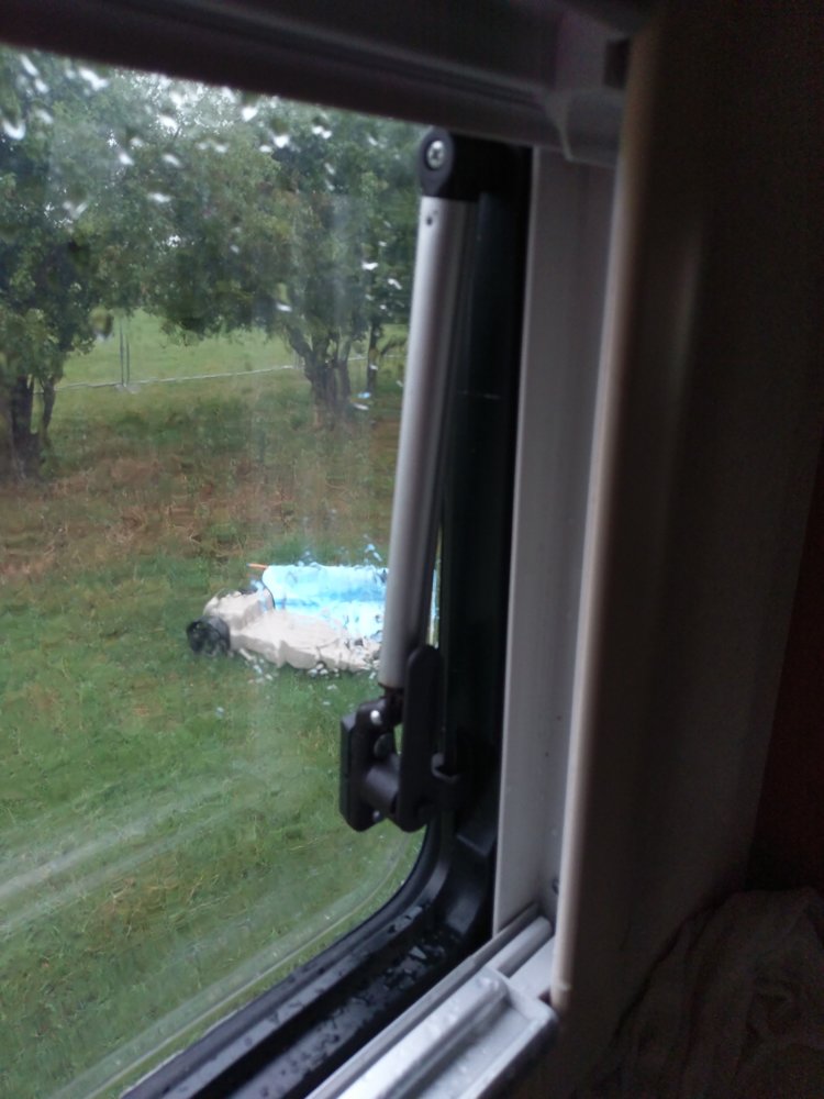

Hi, we are at nedwood for the bank hols and anyone who is here knows it is heaving it down. All (literally) of our windows have started leaking.. it is soaking the inside of the van including the bed.
We have been out in the rain before and not had this and the leaking started one window at a time.
Can anyone suggest a temporary / emergency fix to get us through the weekend??
The water is coming into the cadette that holds the blinds and dripping off the flyscreen.
With the flyscreen closed you can see how wet it has got.
To those of you that might think this is a leaky old van ... Well maybe.. bit we just watched another window start leaking in front of our eyes.. went from dry to running water as we watched.. there is water running down the wall which has no signs of previous water staining.
