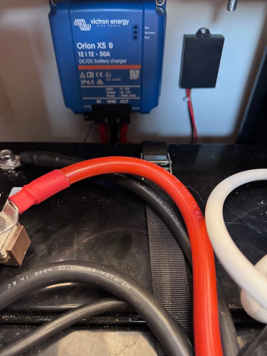

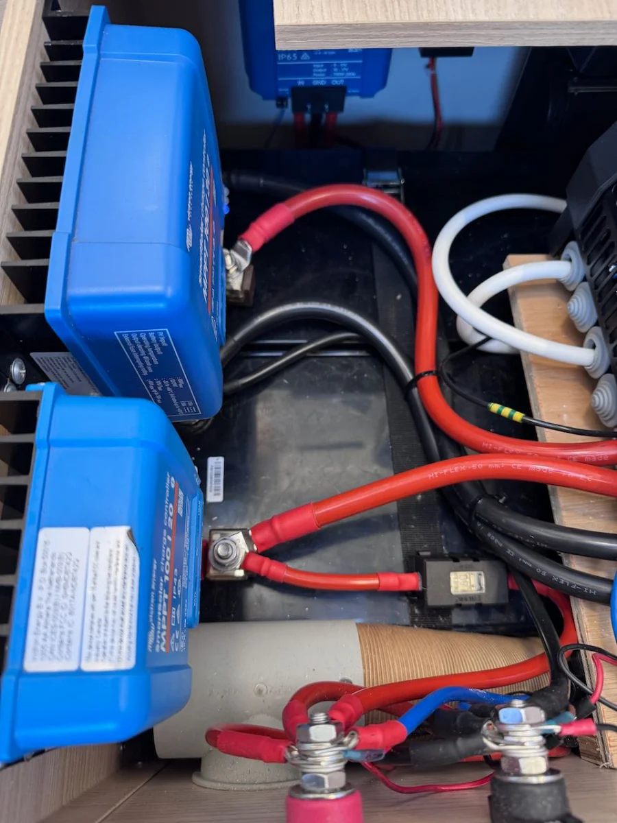

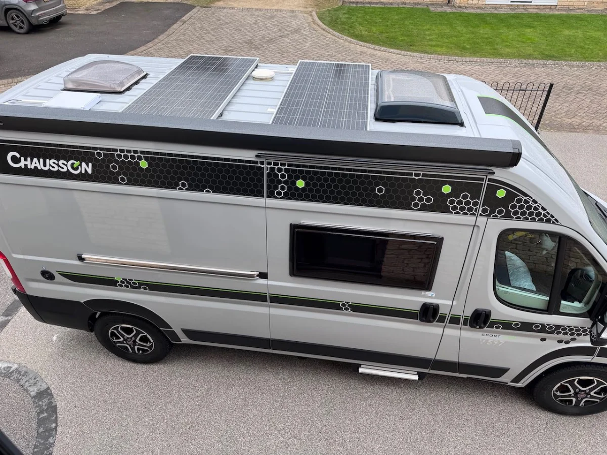

We got our shiny new campervan over Christmas (best present ever!) and it arrived in January. While we’re not wild campers yet, we wanted the freedom to go off-grid for a few days—so upgrades were on the cards.
Thanks to glowing MHF recommendations, we turned to Roger and Nigel at Offgrid Solutions. With solar, B2B chargers, inverters, and more being a mystery to us, their advice was a lifesaver. No hard sell, just honest help and top-quality work.
The result? A professional, immaculate install—and they even fixed a habitation light issue and handbrake sensor quirk (ah, the Chausson/Fiat charm!) free of charge. Way better than dealing with warranty claims!
Now, our 6-metre Ducato camper boasts:
  • 400W solar power
  • A 3k inverter
  • 2 LiFePO4 batteries
  • Starlink Satellite Internet
  • B2B and MPPT withBluetooth Management
It’s a beauty, inside and out, and everything runs flawlessly. My OCD approves. 😄 Ready for some off-grid adventures!

Hi Andy,
Yes, they installed the Starlink mini dish using their own custom "mini mount."
To add a layer of complexity, I requested a LAN/Ethernet connection from the dish to a firewall security device in the van.
Offgrid handled everything—installing the Starlink mini, running power and LAN/Ethernet cables, and adding an extra 240V AC outlet for the security device.
The installation is seamless, with the dish mounted neatly on the roof and the cables running through an easily accessible cupboard inside the van.

Thanks, Gary. I should mention they used two FogStar batteries and added a dual battery mounting plate for extra safety and security.

Hi Banbury, what speeds are you getting from the mini and do you get internet on the move ( asking that for the Boss 🤔) cheers
Hey Andy, Great question! Our feedback below:
We ran some tests with Starlink, at Moreton-in-Marsh site and left it powered up, on the road back home.
· Max Download Speed: 110Mbit/s
· Upload Speed: ~10Mbit/s (sometimes faster)
· Devices Connected: TomTom, 2 iPads, 4 iPhones, Blink sync module (WiFi security cameras)
Everything stayed connected without a hitch, even with my key user (my wife!) on board. 😄
At home, we hit 170Mbit/s download speed using the Starlink Syncing with Apple iCloud and sending pics via email was seamless. Upload is faster too when static.
Currently testing the power consumption of Starlink, Blink cameras, a fridge, and more, all powered by dual LiFePO4 batteries. Both batteries are at 99% thanks to the sunny weather and solar!
I cannot remember the monthly cost, we have a Starlink deal, with standard dish and the mini. But it’s proven to be brilliant as it allows me to work remotely. 🚐
