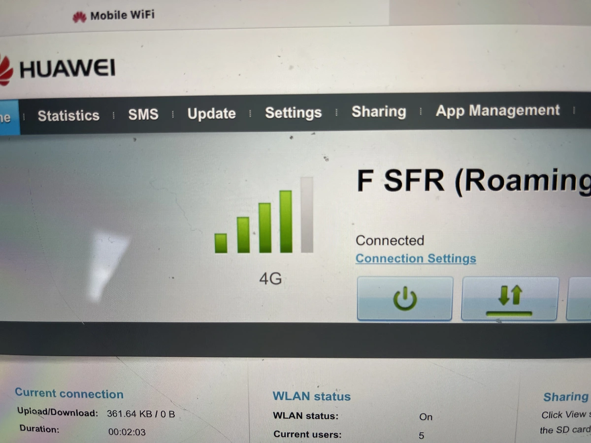

Hi all, at Issoire using a sim from sim corner it’s a Movistar one. Good last night but today nothing. Showing four bars when I log on 192.168.8.1 tried two routers but no joy. Ideas please. Its a 200 gb sim used 85 gb

Many thanks for the replies, I have gone down the on/off remove sim rub and reinstall. Reset both of my routers both show four bars at 192.168.8.1 had good speed last night but no joy today.
That’s what I have done more than once the upload download connector is going up slowly
( bottom left in picture) but nothing happens?

We also know that it's getting some level of connection (if you can call 360k that!) so we know it's not dirty contacts otherwise you'd get nothing at all.
