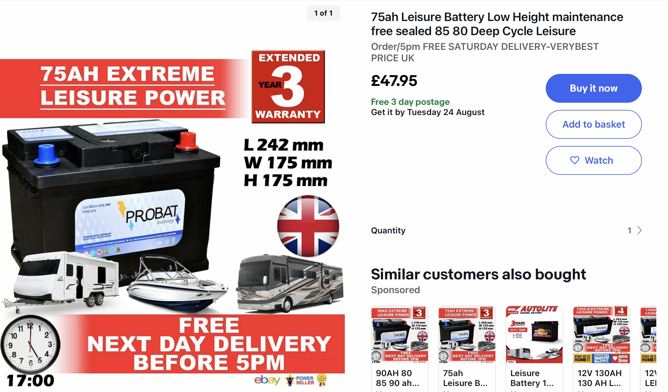

If it was these then they do state 3 day delivery .
whoops, all very conflicting.Like they say, when it looks too good to be true....
75ah Leisure Battery Low Height maintenance free sealed 85 80 Deep Cycle Leisure​
...dual purpose means ?????
USE starting?
75ah DUAL PURPOSE
Specifications
Voltage 12 Volts Capacity (C20) 60AH Capacity (C100) 75AH CCA (EN) 480EN CCA (SAE) 560CCA Length mm 242 Width mm 175 Height mm

Suitable for DUAL POWER use: STARTING
