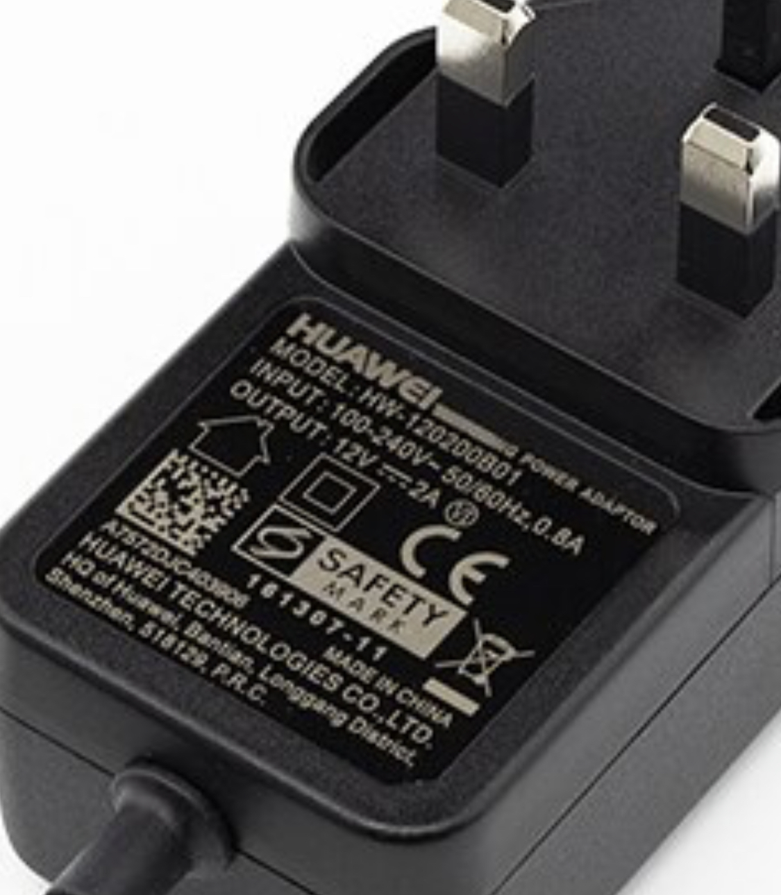

Hi LennyHB. Sorry - the 12v DC 2amp is the ‘out’. Be good if it ran off either with its own step down transformer. Here’s a picture of back of the PSU

All you will do with an inverter is transform 12 volt to 230, then that thing in your picture will just bring it back to 12 volt.
So as been said you don't need one.

Without EHU your 240v sockets will not work. The PSU you have shown pictures of will only work from a 240v source. What people are saying is that if you use an inverter you are going to be wasting a lot of power as you are converting your 12v supply up to 240v, then your PSU is then taking that 240v and converting it back to 12v again. So, rather than wasting money and power, you are being advised to look for an alternate PSU that will run directly from your 12v supply and cut out that middle "240v" part.
