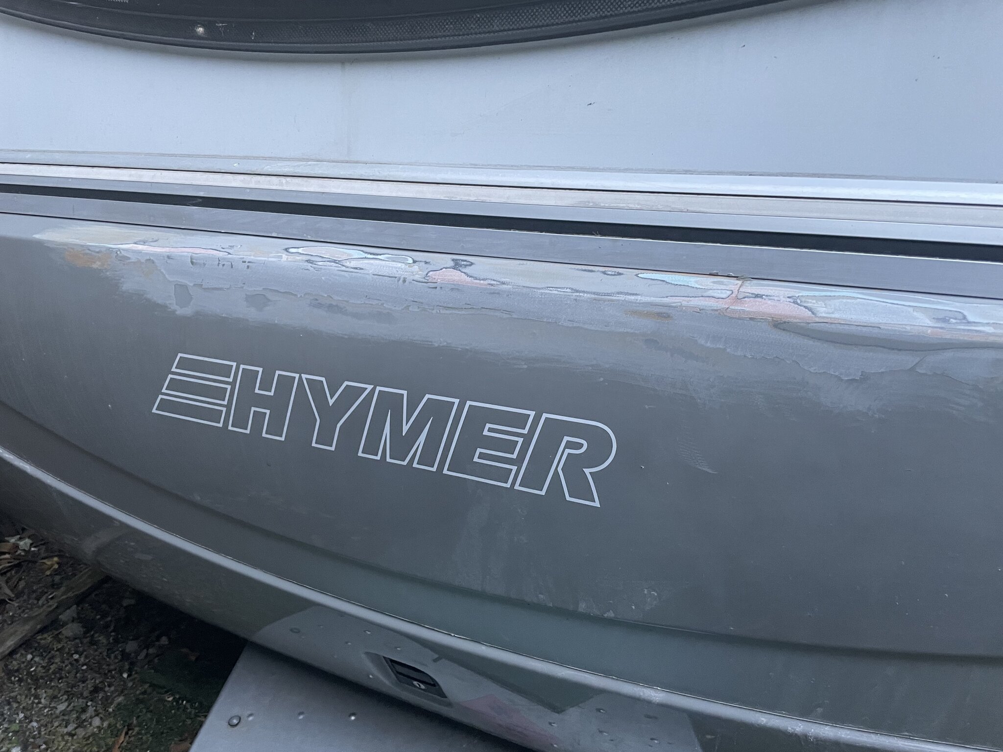

Although Hymer describe the colour of our 2012 b585 as being champagne, the rear bumper (which was in need of a little TLC) looks a silver grey. I took our Hymer down to LKQ in Norwich and with their spectrometer the colour match came back with a match to “Suzuki ODE Satalite Silver” The guy who did the repair for me went a bought half litre tin for the job and never charged me any extra, so it couldn't have cost very much and as you see from the before and after pics, it was a near perfect match.
