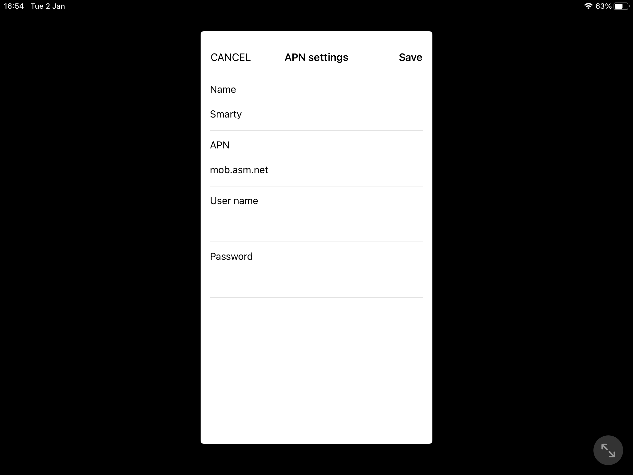

Have you checked the APN settings are correct for the smarty sim.

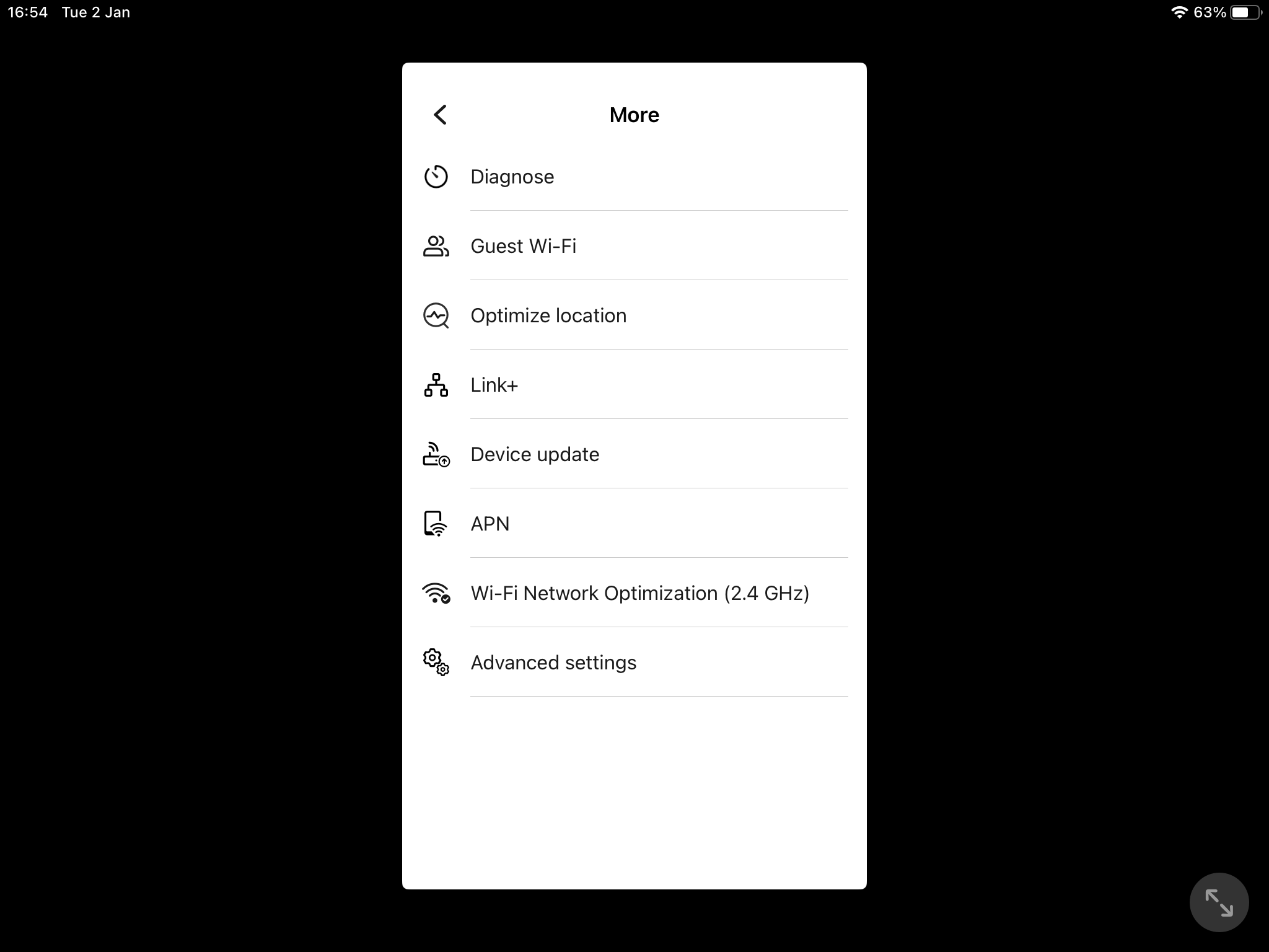

To get to APN settings Hi link
click on “show more” and then APN and the the Smarty option (note this is showing the setting I have which allows roaming)
click on “show more” and then APN and the the Smarty option (note this is showing the setting I have which allows roaming)View attachment 850501View attachment 850502View attachment 850503
im not sure it makes a difference but im connected to 3 even though its a Samrty app so my APN is different you yours, I cant find Smarty when I search netwroks. I also dont have as may options on the More page i can only get APN, wifi extender storage and advanced?
You could try logging in to the router homepage either 192.168.1.1 or 192.168.8.1
