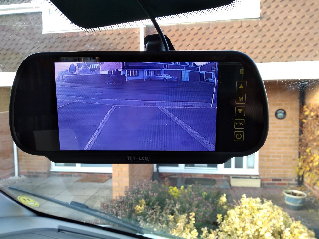

Bought my MH 2 years ago.
At that time it had a working rearview camera. An Eonon monitor.
This slowly started dying so I replaced the rearview camera with an Ebay cheapie.
This worked fine but the image was sort of black and white with only traces of colour.
I then had a discussion with one of the many 'specialist' suppliers out there who said replace the camera with one of our 'better quality' ones.
Result was exactly the same.
Recently the monitor has been failing to turn on so i have today replaced it with an Ebay cheapie.
Result , monitor turns on fine and has a sharp clear picture , BUT, it gives the same washed out almost black and white image as the old monitor.
The monitor has auto switching PAL/NTSC etc and brightness/contrast and colour adjustment.
The colour level makes very little difference , so does the contrast, however brightness works fine.
Anybody any idea of what's wrong?
The only bit of the original installation is the cable.
I have attached a picture which is not very accurately rendered , the image is not really blue as it looks on the image , really it's grey with faint colour.

I don't think the two professionally fitted systems I have had are any better. Same monitor as yours on one.
There are two apparently identical versions of the mirror monitor available on eBay:
800 x 480
and 480 x 234
Despite my choosing the first I came to that happen to have a dramatic price difference the prices are not representative. More typically the 800 x 480 can be found for >£50 and the 480 x 234 can be bought for >£25.
There is a massive difference in picture quality as you might expect.

I'm ambivalent about the quality issue.
The first replacement camera was £11 and the second £35, they performed identically and even the exterior was identical.
My reason for lashing out an inexpensive £18 for the monitor was based on a little bit of research comparing the control panel on the RHS of the monitor.
They are identical to monitors selling for £50 plus.
The menu and the 'no signal' screen on the monitor is in full colour, just not the received image.
I also compared the technical specs as far as I was able. These are the same too.
Yes, there could well be significant technical differences that more expensive systems provide.
The new system perfectly usable , but it obviously lacks something.

When I was playing with ours a while back I got it to look like yours by playing with the white balance, contrast and colour buttons.
You may just need to adjust these again.
Set everything to medium and see if that helps.
Might save you some cash.
Just a thought suppose you have got colour cameras?
Thanks for your suggestions.
There is no white balance, there is brightness,contrast and colour.
As mentioned , only brightness seems to have any noticeable effect.
Yes, it's a colour HD camera.
The image is perfectly sharp and initiates instantly (with the old monitor the image took 5 secs to appear) , just with very little colour.

Looks the same system as is fitted to mine. Are you aware it is daylight sensitive. If you are parked in a dark(ish) area the appearance of the monitor display changes significantly. Are you parked under a bridge/roof/garage?
