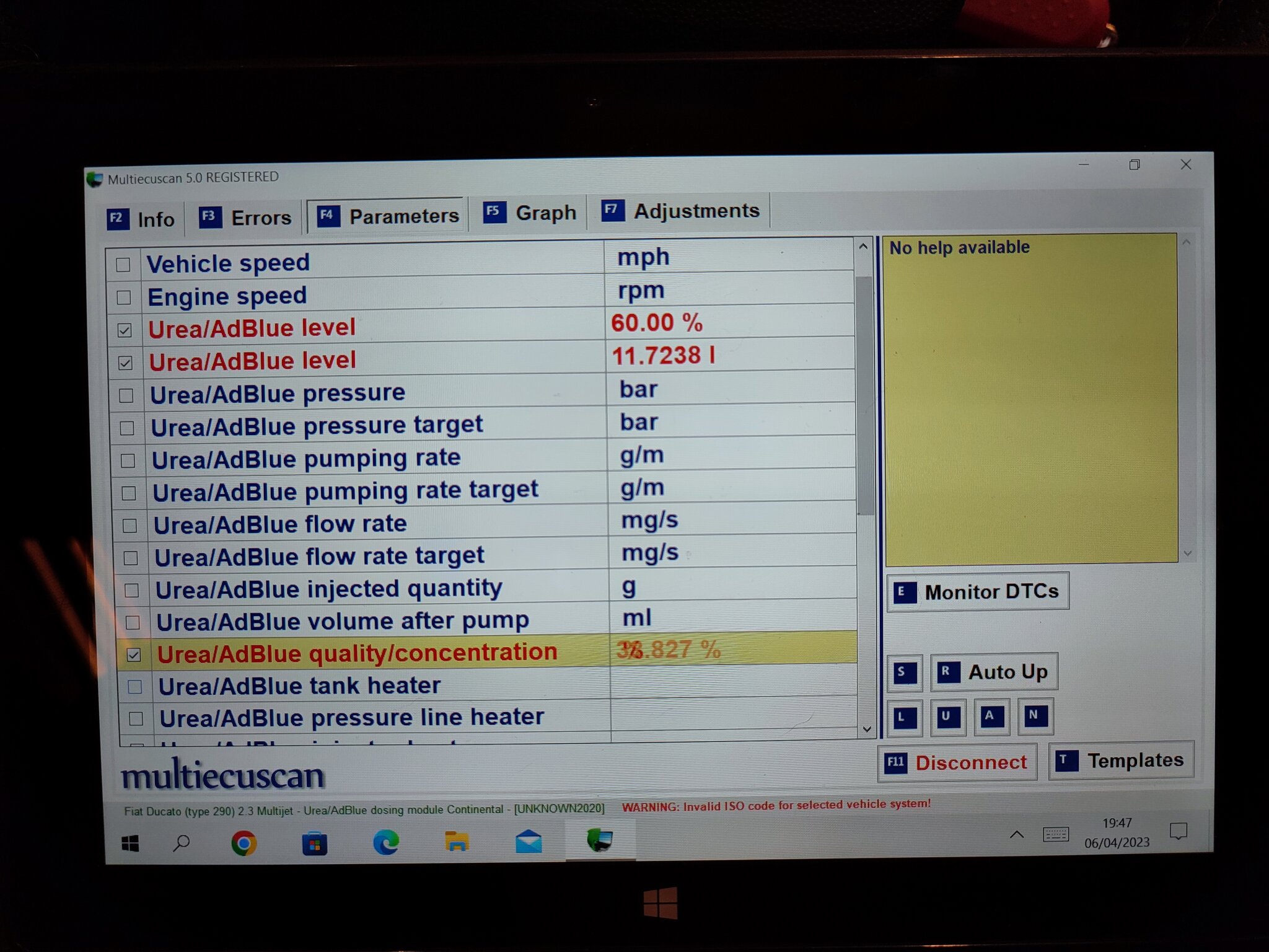

I filled up just before Benidorm Al and drove all the way home and light has not came on yet approx 1450 miles I will plug my multiecuscan in and find out how much is left and let you know 4600 ton 180bhp 9 speed

This is what I have left in the tank Al after the journey home.
bloody hell Dave
am I right thinking that you have used approx. 7.3ltrs and done 1250 miles, if so i’d have doubled that usage
Also are you using to get these reading may I ask
Yeah 1450 miles and used 40% it seems to be getting better with the mileage now at 16000.
The reading is taken with Multiecuscan 👍🏻
