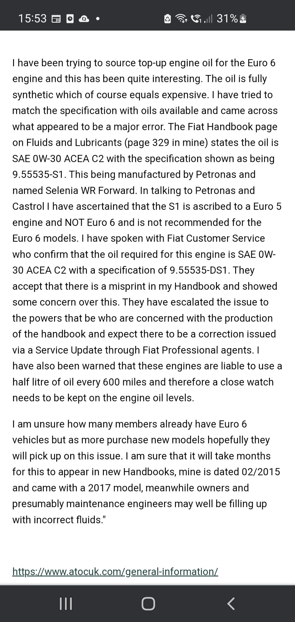

Read this statement as per manual, it explains oil specifications and expectant usage ! Not nice when just spent £85K on your dream is it 😪
Typo there I reckon the 600 should be 6000.
Not on a new engine Lenny, running in stages will consume 0.5 ltr every 600 miles, mine took a litre after 1,460 miles. Then not touch it for 5,000 miles anotherlitre just added !

One thing worth noting is when you top up make sure you use the exact specification oil that Fiat specify, as it you have an engine problem under warranty the first thing they do is test the oil.
If they suspect incorrect oil has been used they will refuse the warranty claim.
Miller's look's best match, although Shell Helix ok as well ! Don't think anyone stupid enough to put anything else in, only as you say out of warranty !
