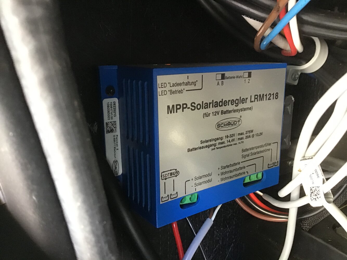

Don’t know if this helps any, but on our S800, we changed the existing solar controller (Schaudt LR1218) to the Schaudt LRM1218. This charges both hab and cab batteries.
