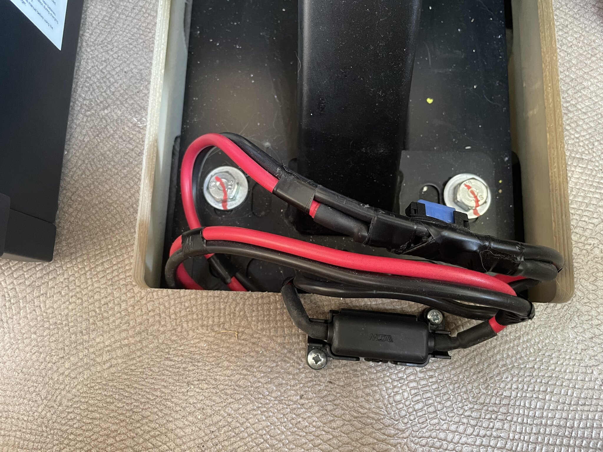

Hi Bob
After working on my Bailey recently, I would suggest you check these first are switched like the photo below
Next I would check you leisure battery and make sure that the terminals are tight. Don’t worry about the numbers shown 😉
If you can find this fuse if it’s blown then you will have no power (on my 79-4t it’s under the travelling seats in the rear) in the black fuse case.
Hopefully it is one of the above. Worth checking your hab batteries with a multimeter too (maybe first thing I would do!)
Good luck
