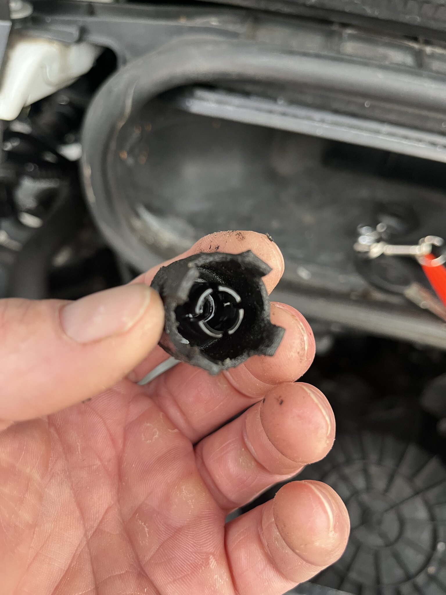

Looks like the external diameter of the protruding pipe is 17.8mm if I’m reading that right.
Yes. That is correct. Although it’s not the easiest place to get a vernier. It’s a see it, or touch it situation. You can do both.
Looking at your pictures, mines not there. It must be somewhere else on the gearbox.
All posted for Korova to test on his van. Fingers crossed our measurements are the same as his model. If not, we will just mod the size. 👌

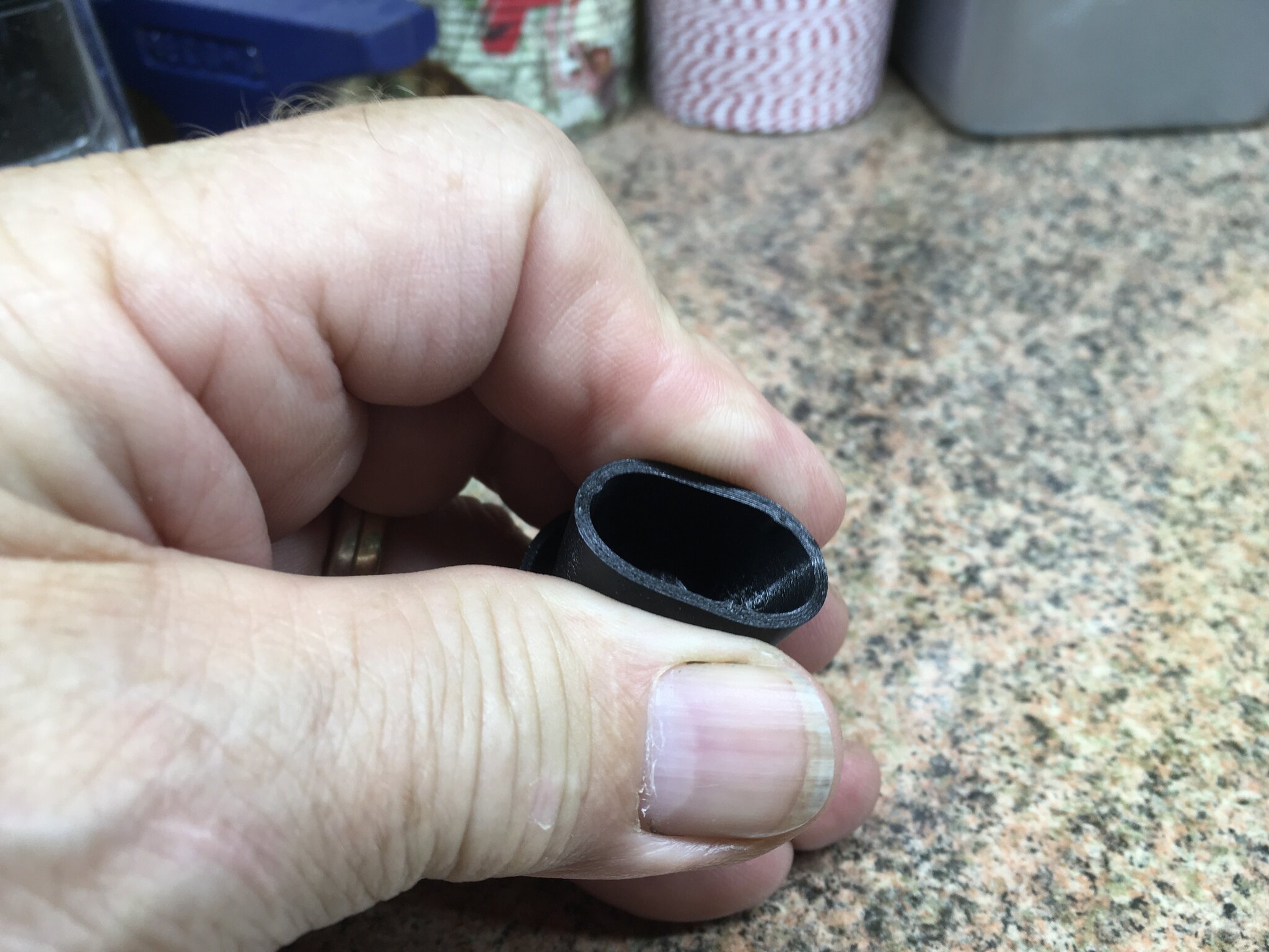

Many thanks to Paul and Chrissy for sorting me out with a 3D printed breather cap that is a perfect fit. And thanks to Landy Andy for the initial measurements, we've learned that the white spigot and black spigot are slighter different diameters. Cheers all!

Hi. Is your breather the same size as Korova. Have you measured the diameter of the plastic tube sticking out of the gearbox. I designed th breather cover myself. If you need one, let me know the diameter and I will dig out my design. Just got to find it.
