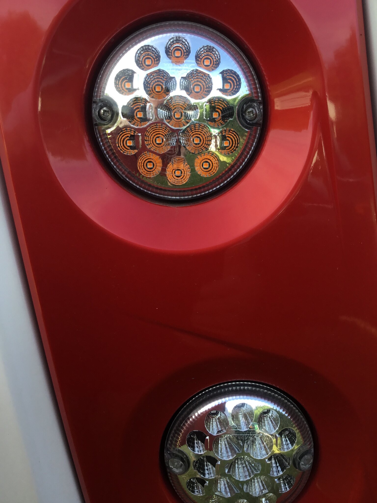

Please could anyone say how you remove the lenses to change the bulbs on an Auto-trail Coach built. No reference at all in the handbook. With no evident fixings I'm assuming twisting the lens will do it but rather be sure than knacker a lens.
not 100 % but i think i just inserted a screw driver in the edge and flipped it off
On mine there are clear plastic covers pushed over the screws.I couldn’t get them out without breaking them.Not easy to get out at all.
This is after removing the bits of plastic which hide the screws.
Better using a plastic panel removal tool as it's better shaped and "gentler" option.(y)
I've read that depending on year of manufacture that some Auto-trails have springs to retain the rear lights in place,
these are similar to down lights retaining springs.
