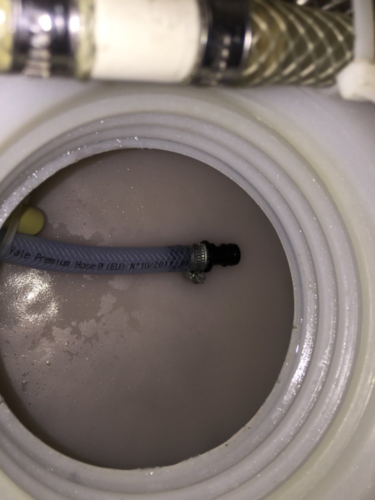

That's what you do & you should do it once a year anyway.
Drain the fresh water tank down so there is only about 10-15 Lt in it then add 3-4 Lt of white wine vinegar. Run the hot taps until water comes out vinegary then try and get the boiler up to temp for a few hours. Then flush with clean water.

@Northernraider To get a descaling solution into your boiler without tainting your fresh water tank fit a ‘barb to make hose pipe connector’ onto the end of your pipe in the fresh water tank. When I unscrew my inspection cap the pipe in there visibly. I simply fitted the barb connection onto the end and when I want to descale the boiler I fill a 10 litre container with the descaling solution and one end of pipe in the container and the other (fitted with a female hose pipe connector) pushed onto the fitting and turn a hot tap on. When all the solution has gone I know the boiler is full. Then boiler on gas, heat the water and then leave for a few hours.
