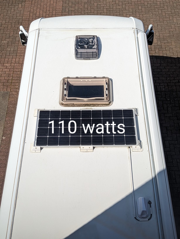

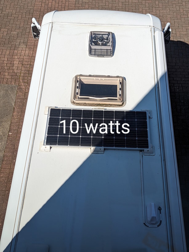

I'm sure many are aware, but your whole panel output is dragged down to whatever the dullest patch of the panel is seeing. If only a tiny corner of the panel is shaded, you'll get terrible output. That could just be the shadow from your aerial or an overhead power cable.
For reference, this is a Victron 175w panel with a Victron Smart Solar MPPT charger. The battery is lithium, about 80% full and accepting full charge.
