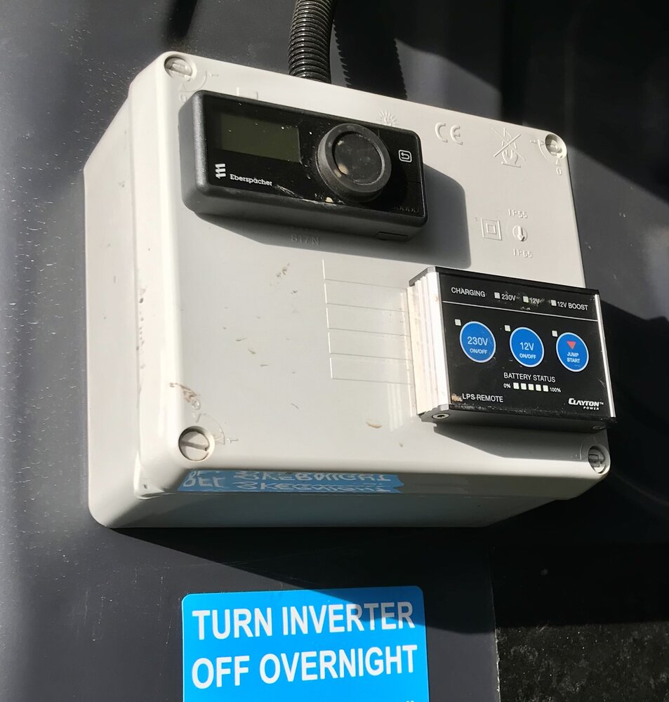

We have lithium power packs in our vans.
They sit in a cradle and run the power for the van but you can just pick them up and use them as a portable power pack.
100a lithium and 1500w of power. Also have a jump start facility.
Good bit of kit.
Good bit of kit. View attachment 467410View attachment 467411
LiFePO4 battery chemistry though(y)
