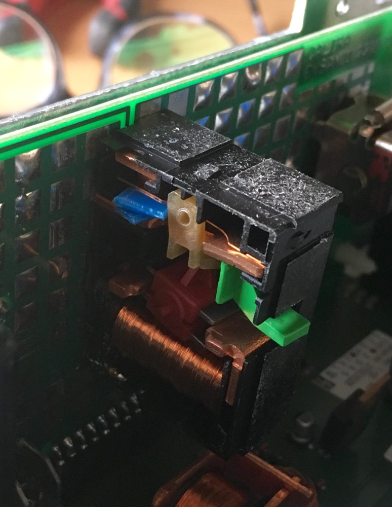

Well folks, I've taken the cover off the Calira unit tonight and discovered a large relay held shut with a cable tie. Upon removal of the tie I find two pieces of blue plastic jamming the switch closed. Doubtless the cause of my permanently live equipment!
I will contact the dealer tomorrow early and invite them to make amends before I post their details here and elsewhere.

Indeed, PDI clearly lacking. However, I must assume they were unaware of the bodge. Habitation check was done in March by another firm and I have copy of the schedule, including control panel.
Ho hum. Easy to get wound up by these things, especially with an imminent Italian trip and no habitation electrics. I must invite them to make swift amends before things get bloody.

It should be possible to have the relay replaced
Or at least the wires diverted to a manual switch

Can only be a relay failure and must be stuck closed circuit hence the off switch having no effect,
As Dave has clarified the main switch is standard equipment.

Thanks for asking. They have offered to pay for any repairs. The trouble is both our local firms are busy until late August. I had a mobile auto electrician around and he put a manual switch in place of the dud relay. I still have no gauges but at least I have full 12 volt appliances and charging.
