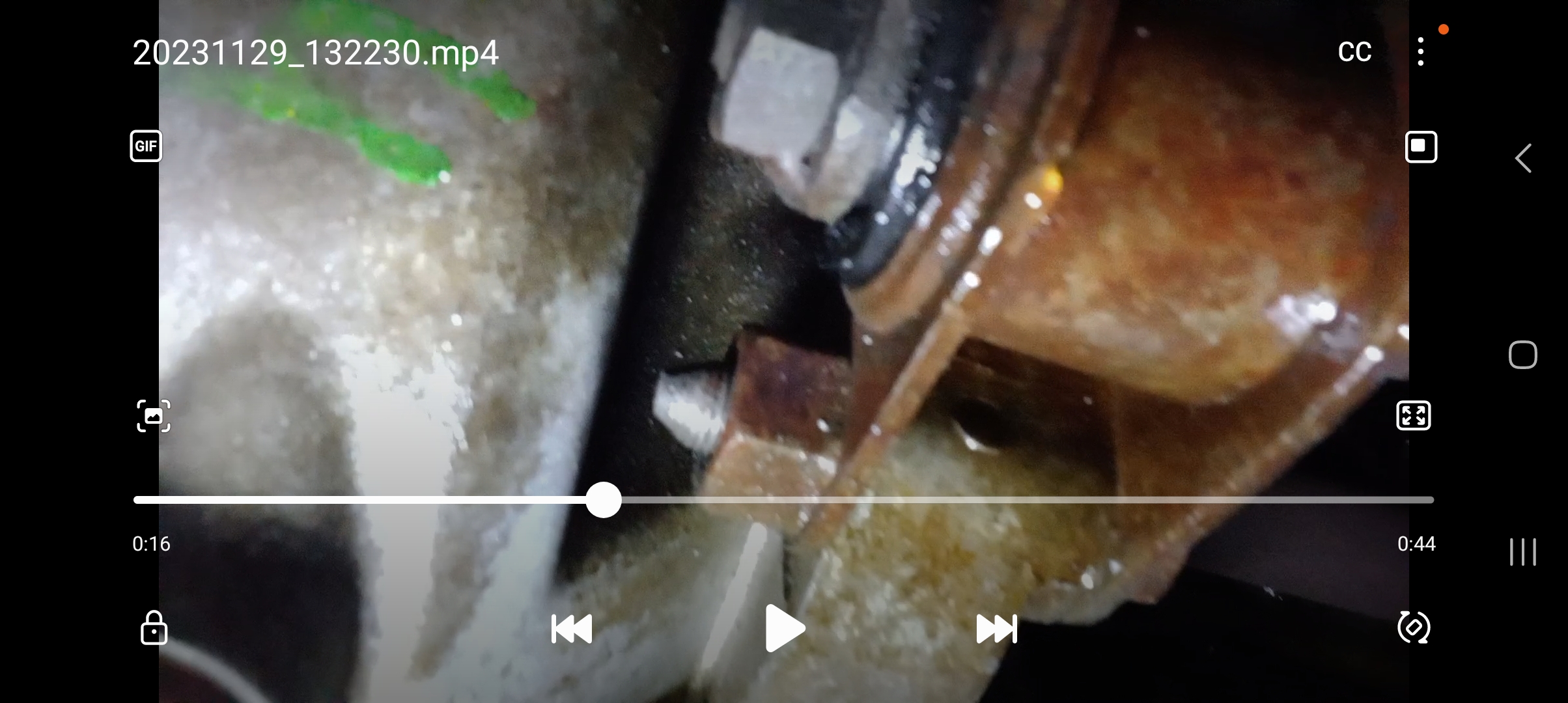

A few months ago I had the fifth gear replaced on my ducato. Ever since there has been a weep/leak on to what I reckon is a gearbox mount as shown in the photo below. The gearbox drain, not shown is to the left of the picture and that is dry. I can't go back to the garage as we fell out with them for various reasons. Anyone any idea where this coming from? I'm struggling to locate the source.

Don't know anything about fiats but has the box been filled up too high.

I'm not seeing any overspill from the breather. I'm hoping its a cheap fix whatever it is, spent 5k on it last year. Thanks for quick reply.

Was the gearbox removed for the repair, I ask as it is often possible to do the repair by just removing the large end plate. If the gearbox was not removed then could be leaking from end plate gasket. If gearbox removed and stripped could be from many places, input shaft oil seal between the clutch and the gearbox, output shafts to the L and R drive shafts etc. Is it dripping out from under the clutch bell housing?

No the gearbox wasn't removed 68c, just the fifth gear end box. Thanks. I think I may have sussed it, I've just crawled underneath (amazing how low to the ground the engine is) and it appears to be coming from the speedo cable plastic housing as shown below. I'll try to nip it up but I'll need to be careful as its plastic. I wonder if there should be a washer of some sort?
