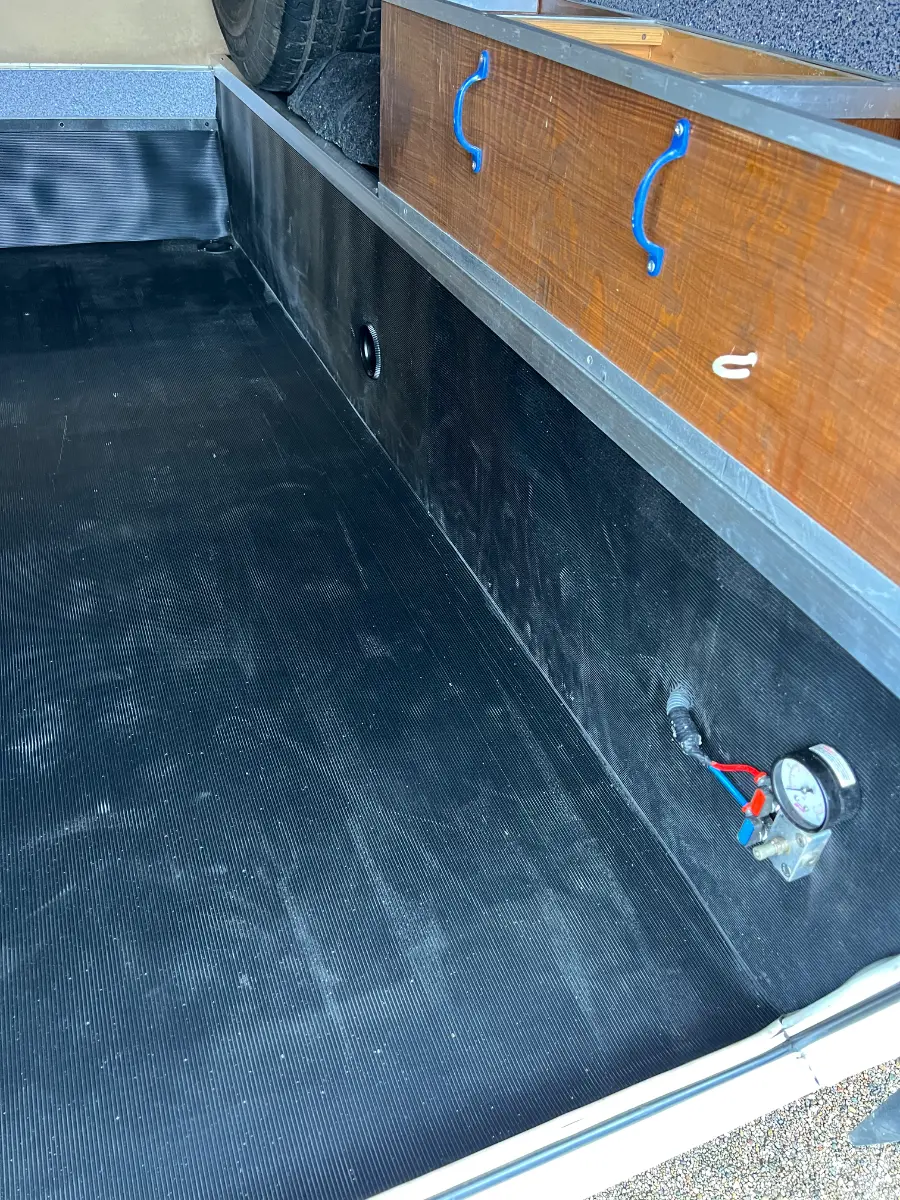

All done - two weeks in the bodyshop at https://www.aeleisure.co.uk/
They’ve done a great job replacing the garage floor and attached side pieces, plus resealing the three windows this Arto has around the transverse bed. While the work was being done, took the opportunity to replace the rear skylight vent too - so all looks very smart :)
The rubberised floor covering works well. What do others use to cover the semi-air top up valve?
