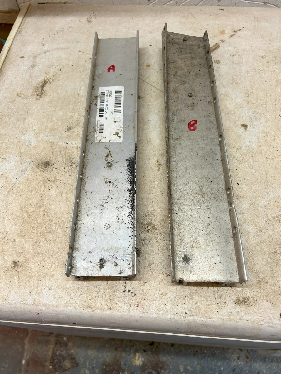

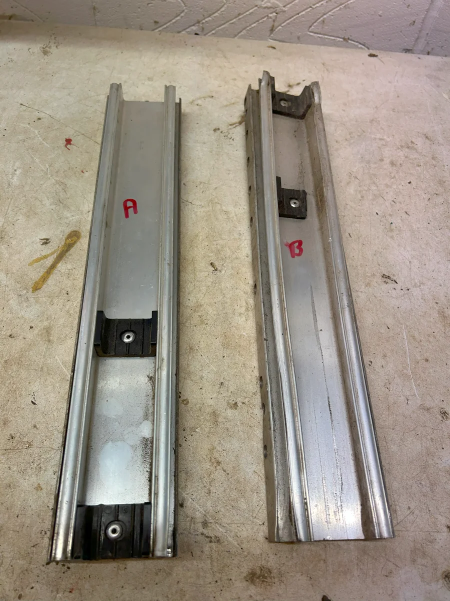

I wrecked my Thule slide out step on my Malibu boarding a Dover Calais ferry when my step hit one of the little "fingers" on the end of the boarding ramp which was sticking up. I ending up buying a complete new step. I kept the old one as I thought it might be useful to someone in the future (y).
I've had a look at my side pieces and the one I have labled "A" is fairly straight but would need a little fettling. The other labled "B" is more mis-shaped but could also be probably fettled, any use to you?

John has spent the day fettling and we do have a working step with a bit of a grinding noise which John hopes is due to sand and dirt as the step has been manhandled on its side for him to take apart. Tomorrow he is going to try and clean it up and see where we are. At present just operating it on its side as haven’t disconnected the wiring from it, we just pulled the fuse.
I might come back to you Treeeev as your side A looks to be the side we damaged? Does your Malibu have an offside sliding door?

My Malibu did have an offside sliding door, I’ve since px’d it for another van. Sounds like a plan as Billericay is just up the road from me👍. I’ll send you a pm with my contact details
