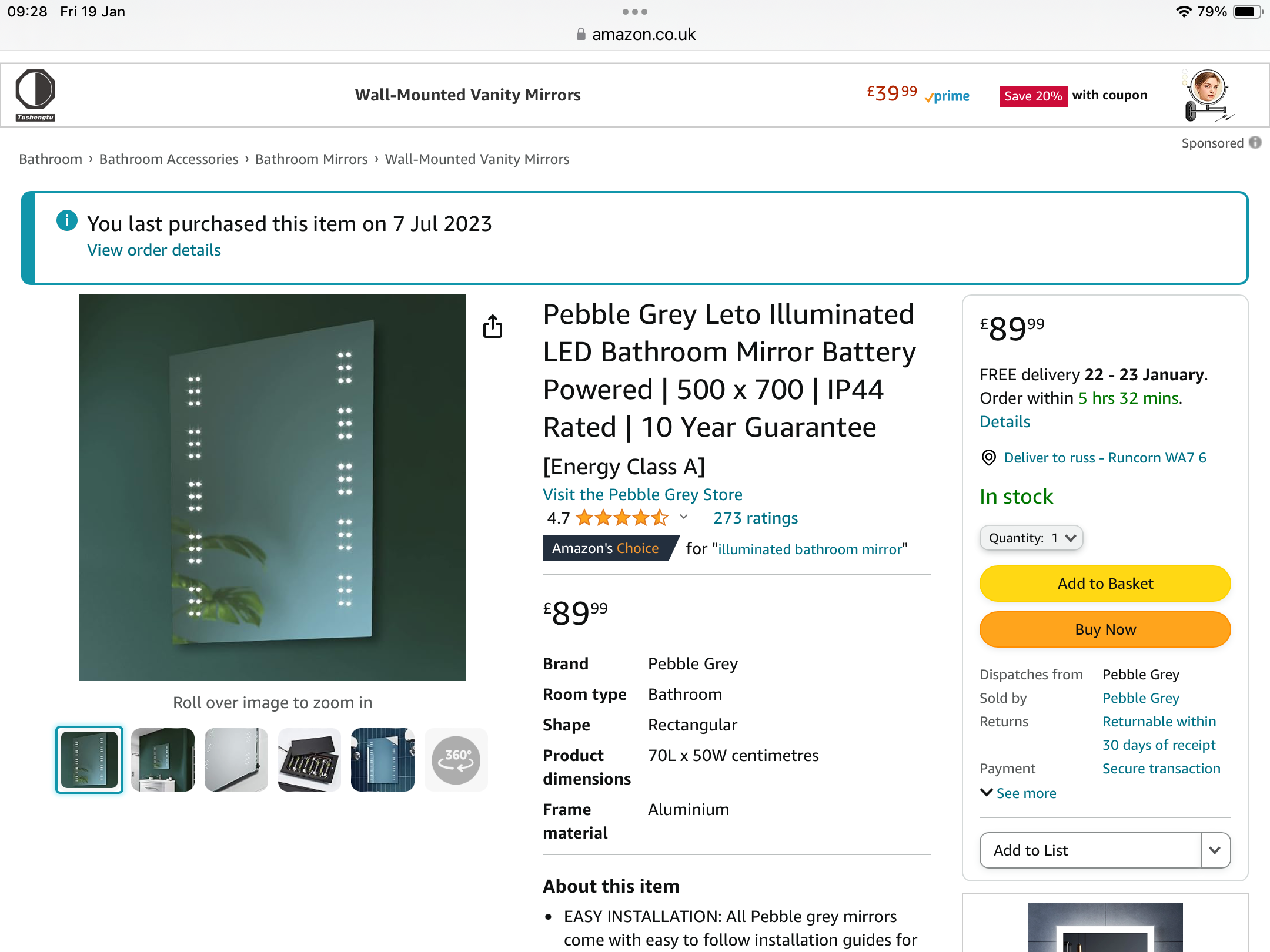

I had the same problem. My solution was to buy a battery operated 12v dc mirror with built in lights. Plenty of them about, but size is the issue. I found this one after a lot of internet searching. We have an Autotrail Apache 632 2013 vintage and your mirror looks to be about the same size, 500x700mm
So how to fit it? This mirror comes with key hole slots at the top corners, I made some really accurate measurements so that the screws I put into the wall would line up exactly with the keyhole slots. Next i removed the lid from the battery box on the back of the mirror and soldered the switch wiring from the switch to the +ve and -ve sides of the battery box. Make sure that the SWITCHED wire is soldered to the +ve terminal and the UNSWITCHED is soldered to the -ve terminal. Test it before you move to the next stage!

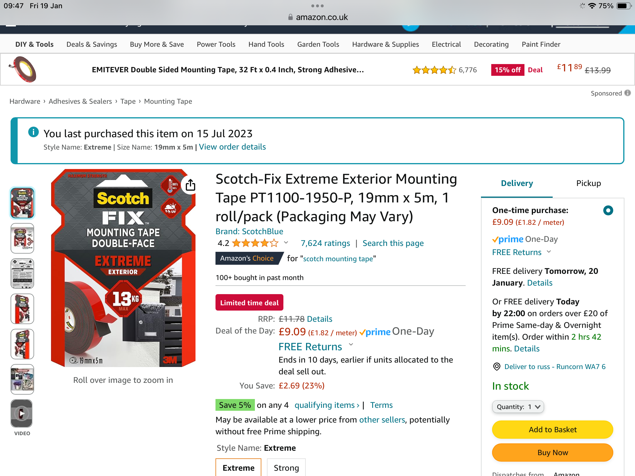

After soldering and testing I stuck a piece of the Scotch double sided tape to the bottom of the mirror, leaving a tag of the backing material hanging below the mirror so I could pull it off and allow the mirror to stick to the wall. Even doing this it took two attempts to get the mirror straight, I had to use a really long sharp knife slid up the back of the mirror to cut it off the first time because it was squint!

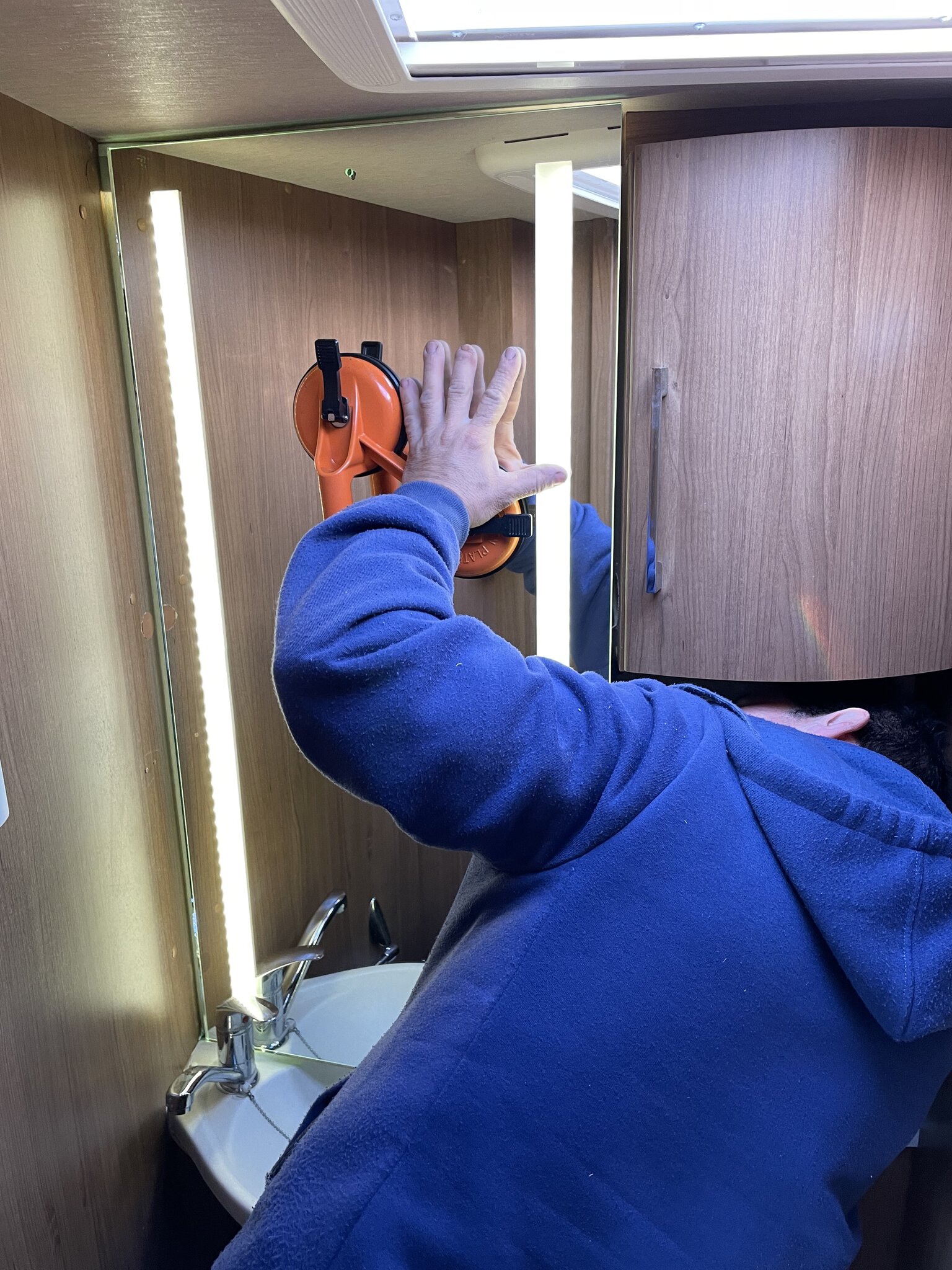

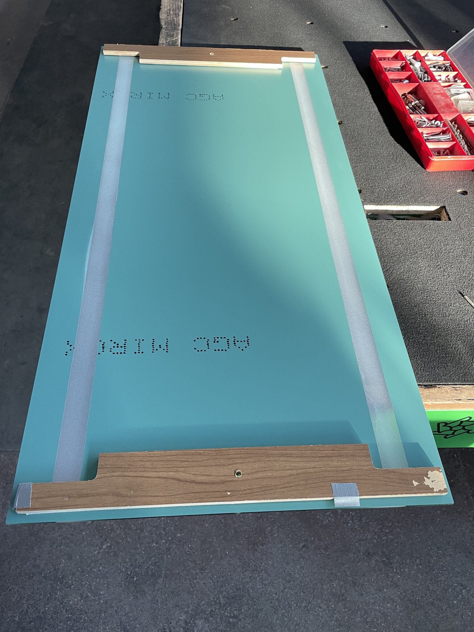

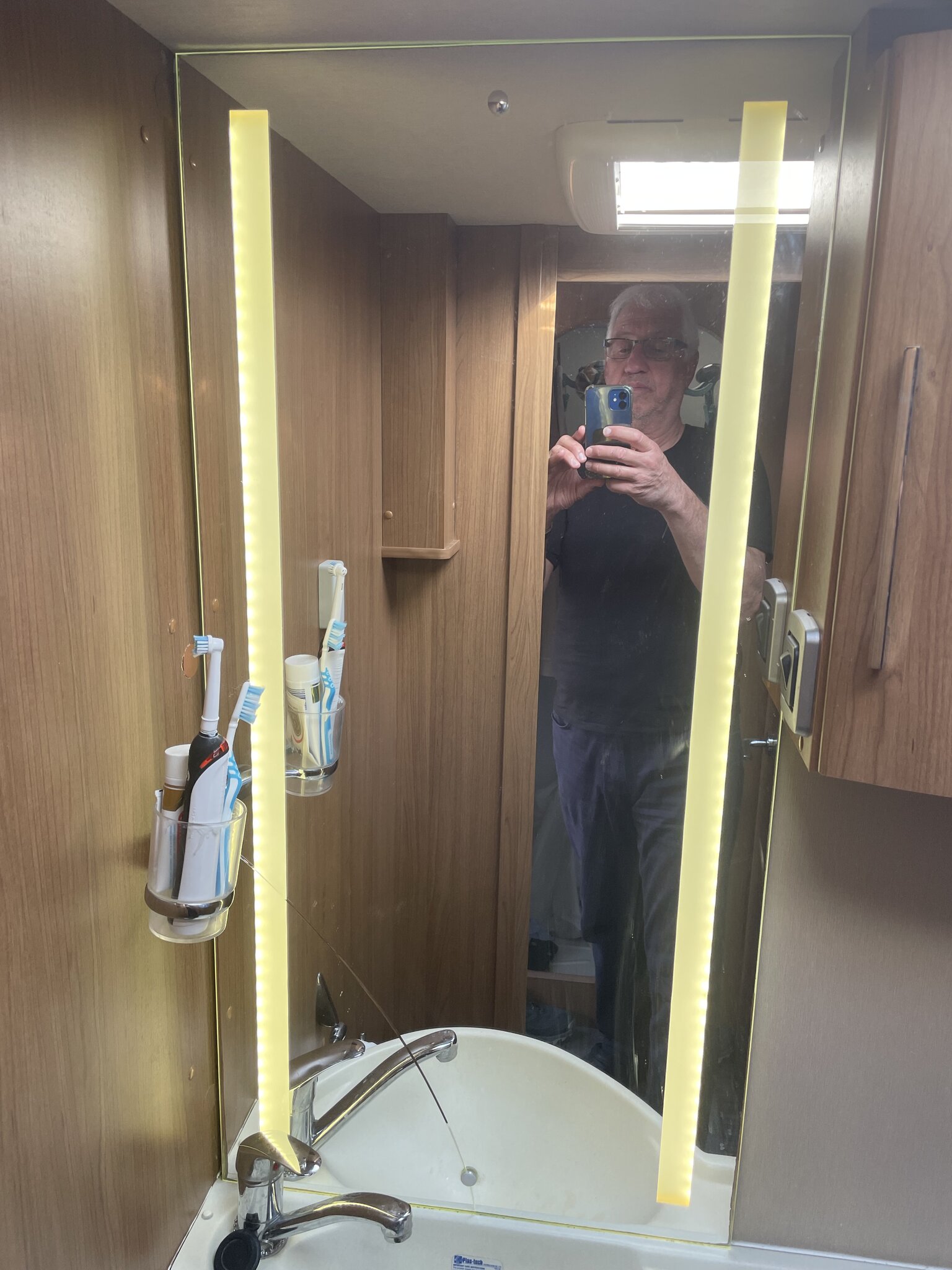

I am in Greece, local friend took me to glass/mirrors factory. One hour work and they replace the broken mirror with a New one (used the old lights) total cost €84.82 including VAR (I could pay €70 if I had cash).
