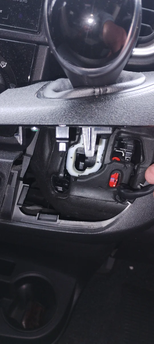

Hi guys just driven 2 hrs, stopped for Mrs wanting loo ! 2022 ducato 9 sp auto , started up but not able to engage button on shaft to select gear , also will not let me remove ignition key , any ideas please .

The gist of it is /was , couldn't select gear as something not talking to something else ! And that not communicating with the solenoid to release the key , so at the moment the surround that goes around gear selector is off so I can press a red lever that lets me select gears and facia around key lock off so I can pull tab on solenoid to release key , if that makes sense ! A pain but it works , having a jaunt round Cornwall at mo so will arrange repair on return to Suffolk , I think it's out of warrAnty too but my mechanic thinks not !

The red piece is what I need to press to select gears
How did you find that out?
Glad the breakdown guy knew how to get you back on the road.
Looks like a fair bit of trim/facia has to be removed to gain access to the lever and the knob. Is that a complicated task?
Impressed the breakdown guy knew all that! There is a section in the Ducato manual which describes how to remove the key when the transmission doesn't want to release it. It involves removing some trim and using an allen key, but I can't find the section now.
