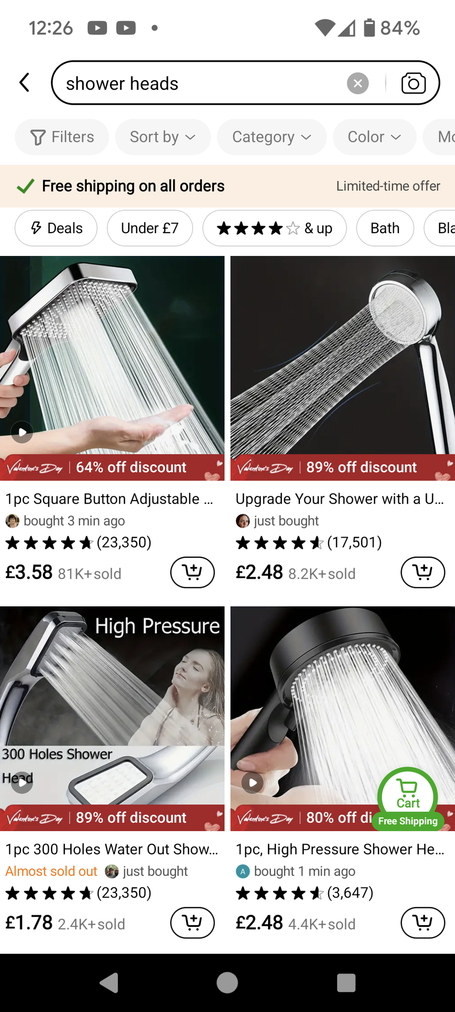

Temu have loads of different ones at very little money.View attachment 863526
I have one of the bottom right type on the hose in the garden to wash the dog. Had a message just this morning saying not to use with an electric shower.
Please note that shower heads with a stop button are incompatible for use with electric showers as water may be emitted at excessively high temperatures which can cause injury. Therefore, this product must not be used with electric shower systems.
If you have not yet received the item, please be aware that it is incompatible for use with an electric shower system.
If you purchased this product to use with an electric shower system, please dispose of the product safely and contact us for a refund as noted below.
If you purchased the product(s) for use with an electric shower system and would like to have a refund, please go to “Your Orders” and click the “Return/Refund” button for the product(s). Our team will then process the refund request accordingly.

That's the same with any shower head with a stop button
