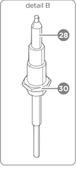

I am not very technical. When you say replace the thermocouple, I assume that just the probe rather than the whole mechanism from the probe to, and including, the valve mechanism. i.e. The bit numbered 28, above?
yes, just the probe, but try moving it closer to the flame as suggested. the fact that it stays alight for a bit before dropping out suggests that may be the problem.,.
